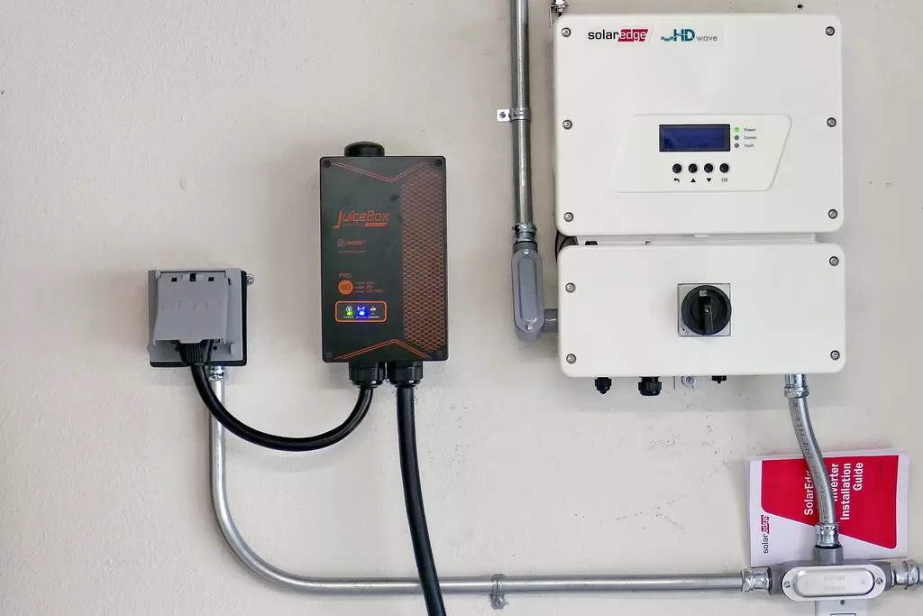

Dan Albrich, My level 2 JuiceBox Pro 40 is a 40 amp which works fine with the Clarity. I have it about 1 foot from the 220V outlet as you suggest.
I have the same JuiceBox. Works very well. Bought on Amazon and had a neighbor/electrician install in my garage. The app is good but not ‘regionalized’ for where I live (MA).

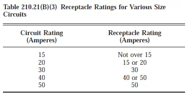

NEC 210.21(B) explicitly allows a 50 amp receptacle on a 40 amp circuit. From the referenced chart, you can see it is OK to use a 40 or 50 A receptacle (there is no 40A receptacle).
If you believe doing so would violate the NEC, I'd like to see a reference to the specific section.
I think what @Electra is getting at is not that the 14-50 receptacle can’t be used in a 40 Amp circuit, but that the 40 Amp EVSE needs a 50 Amp circuit not a 40 Amp one. Using the 80% rule for continuous draw, then 80% of 50 Amps is 40 Amps and all is well. Same reason I had to use a 40 Amp circuit for my 32 Amp EVSE.
