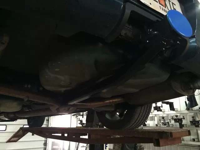

The Tork-lift hitch is a robustly built device. The weak link is that we’ve bolted it to points on the car that are designed to crumple in an accident. And, Honda states in the manual that the vehicle is not designed to tow. Adding a drop/riser, adds a lever to the receiver.

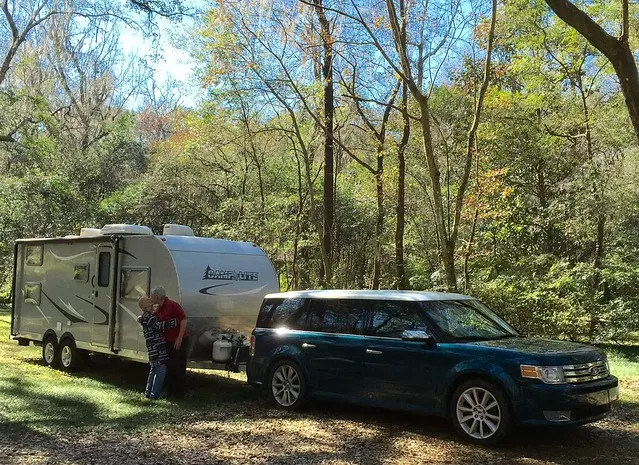

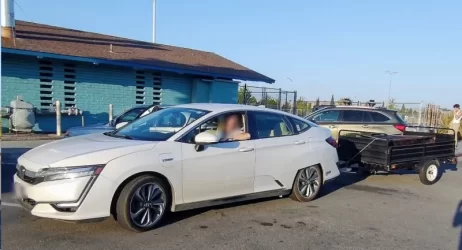

We bought an aluminum travel trailer. We decided to use a Ford Flex as a tow vehicle. The trailer specs said the tongue weight was 440 lbs. The maximum for the Flex is 450 lbs. So, close but just in limits.
Which was fine, until one day we weighed the tongue and were a bit dismayed to find that loaded normally the tongue weight was 620 lbs. What to do?
Through an online forum, we found a place in London, Ontario that specializes in beefing up smaller cars to tow bigger loads. On the Flex, the receiver was just hanging from sheet metal unibody. The fix was to weld on a beefy reinforcing bar that ran the load forward to the rear suspension:
Anyway, over 20,000 uneventful and happy miles of towing to date.
As an aside, I’m a member of the Experimental Aircraft Association, and own an Experiment Light Sport plane. As such, I’m not adverse to judicious experimenting, which again as served me well so far. But to each their own, and you do you!
Which was fine, until one day we weighed the tongue and were a bit dismayed to find that loaded normally the toungue weight was 620 lbs. What to do?
Travel trailer manufacturers, almost always, provide a tongue weight for a dry/empty trailer. Tongue weight should be 10-12% of the total trailer weight. I’d bet your TT weighed 4400lbs as delivered. As you discovered, adding weight to the trailer increases the tongue weight.
Your tandem axle trailer is probably equipped with 2, 3500lb axles, and may have a GVWR as high as 7000lbs. Your tongue weight indicates a trailer weight between 5200-6200lbs, if properly loaded. However, the tongue weight is merely a result of putting stuff in the trailer, so the ratio may not be within spec. Once you know the total weight of the trailer, axle weight plus tongue weight, you’ll be able to determine the correct tongue weight. You may be able to actually reduce the amount of weight on the hitch.
Vehicle manufacturers follow a similar practice with their maximum numbers. The 450lb maximum tongue weight indicates that the Flex has a 4500lb maximum towing capacity. Ford typically leans toward the 10% formula. The car as a whole is designed to tow a trailer that weighs, at most, 4500lbs, and has, at most, a 450lb tongue weight. There’s more to it than just ripping the hitch receiver off the car.
What’s the curb weight of the car? What’s the payload or passenger and cargo carrying capacity? The tongue weight needs to be subtracted from the payload figure. What’s the GCVWR for the Flex? Why tire pressure are you running when towing?

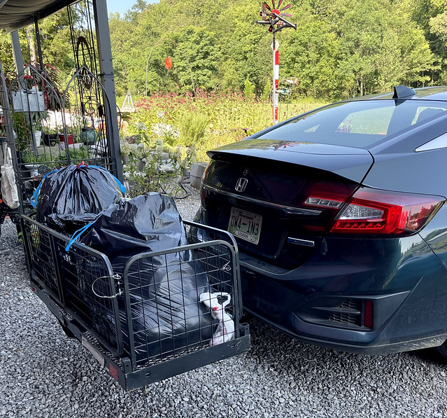

Still haven’t towed, but the hitch and carrier came in handy this morning for a trip to recycling:
We normally use our Ridgeline for this, but the kids were using it this week.

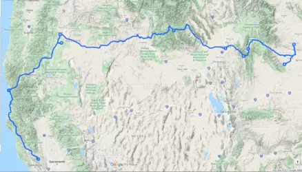

Test Run Two - August 2021

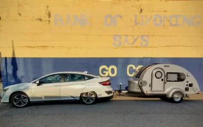

10 Day Drive from Wyoming to CA with 1,100 lb Teardrop Trailer - 3000 miles with side trips

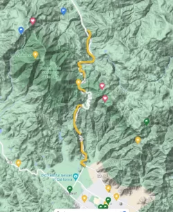

Highest Pass - 10,000 ft
Grades - not sure, I did route planning to avoid the steepest of grades
ICE - I learned to use autopilot in flat freeways.
I drove manual on any hills and kept 'RPMs' to line 3,4 of circle display
Preferred to go very slow (35mph sometimes) and keep the ICE from revving too high
Fuel Mileage - Dropped from 43(ish) to avg 30 for the trip - all ICE I did not mess with EV
Tank Indicator - Dropped/adjusted from 300mi to 220mi after 2-3 tanks worth of towing

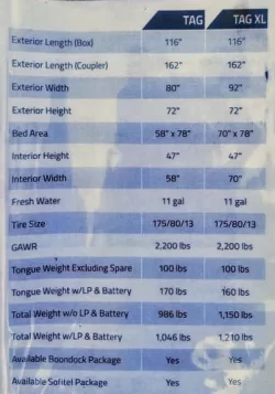

Trailer: 2018 T@G Teardrop NuCamp
1100 Lbs. dry weight
200 Lbs. gear in car
1 passenger

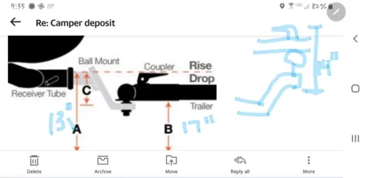

Hitch: Curt 45240 flipped for 4"rise to get to 18" for Trailer
See previous post for Torklift ecohitch receiver and wiring

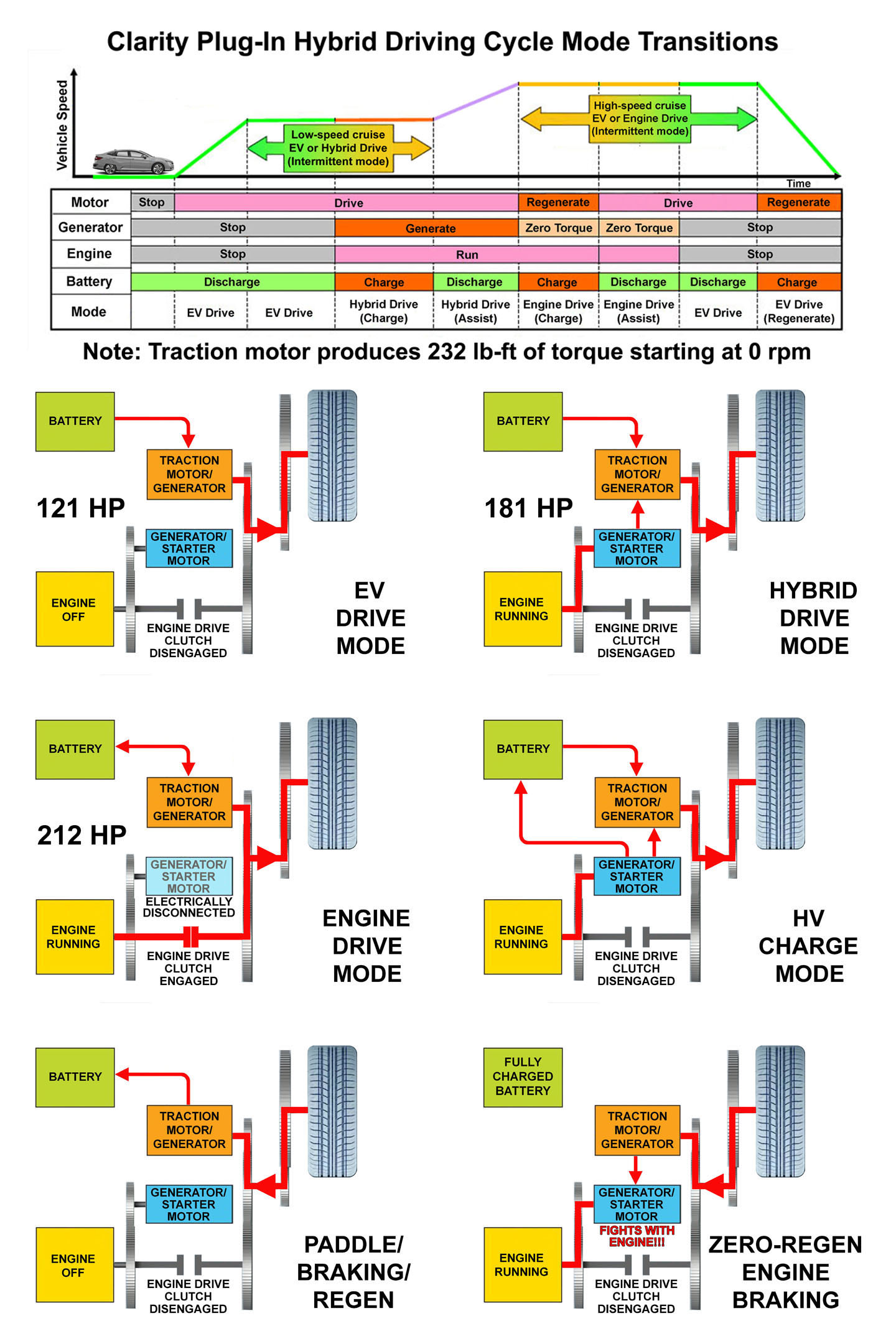

The only time there's an actual "transmission" in play is when you're in Engine-Drive Mode (sometimes called "Gear Mode" because of the gear that appears between the wheels on the power-flow screen). The Clarity only activates that mode when you use HV, are traveling faster than 45 mph, and not pressing too hard on the accelerator pedal. When that single-speed gearing is not using the engine to propel your Clarity, the traction motor is doing all the work.

When designing their plug-in hybrid car Honda (and Chevy) discovered that at speeds over 45 mph, it's more efficient to connect the engine to the wheels through gears than to have the engine generate electricity to power the electric traction motor. Because plug-in hybrids are all about efficiency, Honda implemented the extra hardware and software required to make the mechanical connection between the engine and the driving wheels and called it Engine Drive mode.
Engine Drive mode can happen only when you've selected HV because that's when the Clarity's computer brain can decide the most efficient way to move the car down the road. In HV, the Clarity can select battery power only (EV mode), battery+engine/generator power (Hybrid Drive mode), or Engine Drive mode (the battery can contribute here, too). Here's a chart I made years ago that illustrates the different drive modes. The bottom right corner, Zero-Regen Engine Braking was pure speculation on my part. Also, the 212-hp in Engine Drive mode is incorrect--I still don't understand how more than 181-hp is possible.
