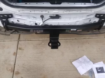

I've just installed the EcoHitch and harness to tow a small motorcycle trailer for my kids' 125cc dirt bikes.
I admit I know nothing about towing. I need the ball mount for it, but I have no idea what type and I could use some help choosing.
Also, when I go to UHaul to rent a trailer, it obviously won't let me book a trailer if I choose the Clarity, has anyone been able to successfully rent a trailer from them regardless?
Any recommendations for or against any installers in the Austin, TX area? That "ecohitch" seems to be the one to get, but I'm paranoid about somebody bad at their job effing up my car during the install.

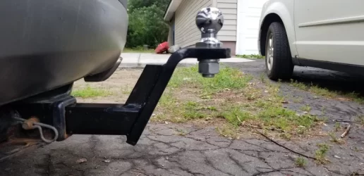

1. Google towing weight distribution - you put more of the weight forward of the axle or center of trailer, more weight on tongue than the rear. Overweight in the rear leads to uncontrollable swaying and crashes. (maybe not with light motorcycles, still, the physics applies)
2. I got a Curt 45070 with a 4" rise (it's reversible, with lower load rating when reversed)
https://www.amazon.com/CURT-45070-T...C/ref=sr_1_2?keywords=curt+6+inch+drop&sr=8-2
I tow a NuCamp T@G which is over 1200lbs. with it. - had to use this 4"rise to keep the trailer flat.
Photo attached

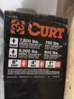

I suspected a flipped hitch would have a lower rating but never found the derating guidance. Can you provide a reference?
Just look at the AMZ link, all the deets and ratings (either direction) are listed there. Way more than you could safely tow w/this vehicle.
(rise position: 6,000 lbs. GTW, 600 lbs. TW)
