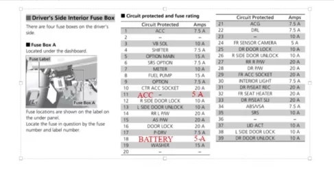

Hi Vicw, Thanks for your post back there. It is helping me hardwire my dash cam. Btw, why did you have to use two fuse slots as shown in the picture? I suppose only one of them is needed to power on the dashcam unit. ?
Also, did you install it to an always powered on slot ?

As I recall, the wiring kit required connection to the 12V Battery (Pin 18) and the 12V Accessory (Pin 11).

Parking feature requires always on, while the regular dashcam requires switched, so usually you attach to both. If you don't want parking, I wouldn't bother with the fuses--just use the switched mirror power
