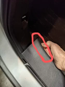

I got my Viofo A129 Pro Duo today, and have installed the Dash Cam. I'm still contemplating the Rear Cam Install. Thanks to @Kyle's Clarity for his detailed descriptions of his install, which really helped.

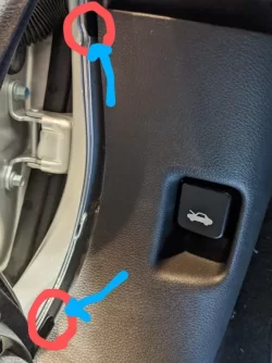

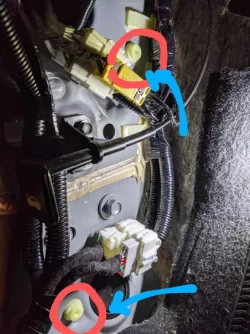

I do want to elaborate just a bit on the removal and reinstallation of the cover panel, in the area of the fuse block, in the hope that it might simplify things for the next guy to try it. I struggled getting that thing apart for an embarrassing amount of time - fearful that I would break it, or one of the adjacent parts. Once I had it out, and studied it, I found that there really are only 3 steps necessary to easily remove or install it, without pain or damage, and that either can be accomplished in about 30 seconds.
1. Reach under the edge of the adjacent floor cover, and yank it up, far enough for the hidden projections under it to clear their hold on the cover panel.
2. Lift out the door weather-stripping adjacent to the cover panel. (Not to worry, it just gets pushed back on afterward, with no damage.)
3. Pull the cover panel towards the rear of the car, about an inch, or so, and extract it to the right side.
Reassembly is mostly the same steps in reverse, except that you need to assure that slots in the 2 hidden attachments are engaged with the 2 round buttons that are attached to the frame. You can test by attempting to pull the cover to the right after pushing the cover panel in place.

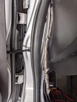

Overall, the project went really well. I did remove power from the 12v Battery, by disconnecting the Negative terminal, to avoid any possibility of blowing the Airbag when I opened up the A-Frame.

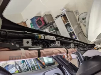

I installed the cable down the A-Frame on the Windshield side, above the airbag, and tie-wrapped to the existing plastic conduit, and I left a loop of cable near the top, in case I decide to move the cam later.
I also wrapped the cable with foam insulation in each area where I wasn't able to tie it down, to avoid movement and rattles.

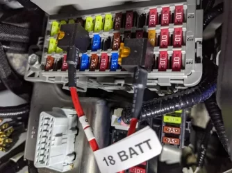

I also opted to connect the Hardwire Kit wiring to Fuse Slots 11 (ACC) and 18 (Battery), so that I could easily dress the wires away from the OBDII port.

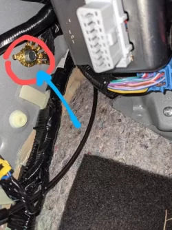

I also used the multi-connection ground bolt for the Ground Wire of the kit. It's a 10mm head on that bolt, and very hard to manage with sockets or closed/open end wrench, but I finally was able to do it. The screw that holds down the manual release for the charging cover would probably work just as well, actually.

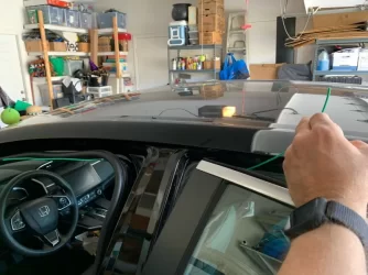

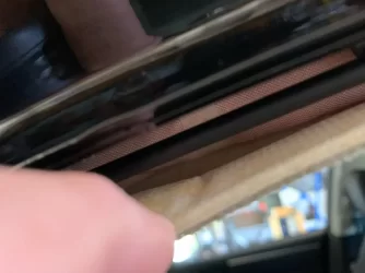

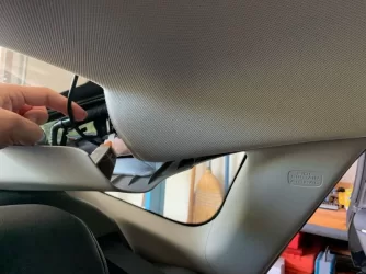

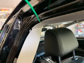

I just installed this same dash cam system last week, front and rear, and I used pretty much the same method for wiring the front camera as @vicw. Did we all get the same Amazon flash deal a couple weeks ago? ;-)
For the rear camera wiring, I ran the USB cable from the camera over to the A-pillar, and routed it over and beyond the airbag to stay out of its path. I then pulled the weatherstripping from the front and rear doors, and tucked the cable into the void space between the headliner and the side curtain airbags.
The only places where it was tricky was with the B-pillar and C-pillar since they have clips that apparently have to be broken in order to pull the covers off. I ended up pulling the pillar out as far as it would go (about 1/2-3/4") and running some stiff electrical wire between the front and rear door, being careful to stay away from the airbags. I was able to fish the USB cable through while keeping it away from the path of the airbags if they were ever to deploy.
I had to do the same thing with the C-pillar, but also had to pull off the D-pillar trim in order to fish the wire through. There are no airbags in the D-pillar area, but it won't come off completely without the C-pillar being removed first, so I had to bend it out of the way enough to get the cable through, then snap it back in place. I had an extra 3-4ft of cable left, so I just tucked it into the headliner behind the rear camera.
Looks a little trickier than it actually was, but worth it to have both a clean install and a rear-facing camera. Took about 30 minutes to run the cable from front to back.

You're correct about the first photo, I was pointing up at the gap between the door and headliner from just outside the car. And it is the USB cable that you see in the photo. From that angle it looks like it's in front of the airbag, but it's actually behind it. I think it's out of the way if it were to deploy, it would likely inflate downward in front of it, but I may end up going back in and taping it to the the frame to be on the safe side. There's a little more room there than it looks in the photo.
My first attempt was to run fish tape in the headliner from rear to front to stay well away from the airbags, but there are too many crossmembers in there, and the tape kept getting stuck before I could get it all the way forward. Bummer because it would've only been a 6ft run from front to back that way. The grab handles probably have cover pieces hiding some screws, so you can try that, but it seems like a lot more work to try to get the headliner pulled away.
I didn't think my cable was 19ft, it seemed more like 12ft based on the amount leftover that I had to tuck away.
One other issue I ran into was with the fusebox. I ordered a set of fuse taps based on the link that posted in the first message in this thread, and they didn't fit my fusebox. The original poster had a 2018 model, and mine's a 2019, and my fuses are the low-profile ones and not the standard mini fuses, so maybe they changed them between 2018 and 2019. What year is your Clarity, and what style fuses are in your fusebox?

...One other issue I ran into was with the fusebox. I ordered a set of fuse taps based on the link that posted in the first message in this thread, and they didn't fit my fusebox. The original poster had a 2018 model, and mine's a 2019, and my fuses are the low-profile ones and not the standard mini fuses, so maybe they changed them between 2018 and 2019. What year is your Clarity, and what style fuses are in your fusebox?
My Clarity is a 2018 model, and I used the low-profile add-a-circuit taps on mine, but I suspect either variety would work, based on the photo that @Kyle's Clarity posted.

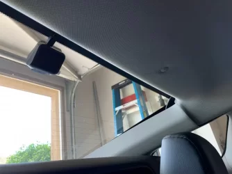

Well, I managed to install the Rear Cam today. It took me about 1 1/2 hours to complete, following the routing and techniques that @Vitamin P showed above. It went well, and all is working, BUT, after completing the install, I encountered a problem that hadn't occurred to me to expect.
Apparently, the proximity of the Rear Cam to the nearby roof antenna pretty much kills the signal reception for SiriusXM, presumably because of RF generated by the cam. XM is not completely dead, but it completely loses signal input more that it has it. I moved the cam about 6" down from the initial highest placement, which improved the performance, but it was still subject to too many interruptions. I was concerned that I might have disrupted the antenna connection, when I jammed about 8' of excess cable into the headliner, but the problem severity follows the distance between the cam and the antenna, so I don't think the cable routing is causing the problem. I also temporarily wrapped aluminum foil over the cam back, and it helped even more, at an acceptable level, but obviously I can't leave it that way.
I temporarily moved the cam to the window in the trunk. I couldn't quite center it, but it's within a few inches of center. I took a test drive with it, and am blown away how good it looks. There is no interior stuff in the image, and no reflections at all, and the angle is perfect, I think. I had no RF interference problems to XM radio from that position.
If I can find a route for the cable, which I think should be pretty easy, and if I can be confident that it won't pop off from trunk slamming, I'm going for it. I haven't tried it at night yet, and the window seems to be slightly tinted, so it might not be wonderful imaging, but I hope acceptable.

Not having read your entire experience I was confused until the last picture. I put mine at the top of the rear window. Much easier installation. And now that I've read the rest I understand. Not being someone that uses SiriusXM I had no idea the antenna would cause problems.

That's true - it's much easier. Actually, I did that first, but the cam caused serious interference with SiriusXM radio. I moved it to the trunk to eliminate the interference, and surprising now get what I think is a better image from that location. I posted a sample pic of the trunk image yesterday.
I was really surprised with the interference problem. It affected SiriusXM very seriously, but not FM, and AM seemed OK, but I just checked one channel.
