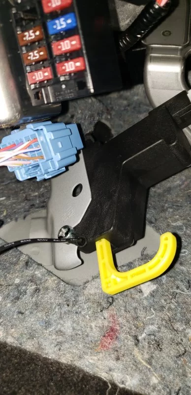

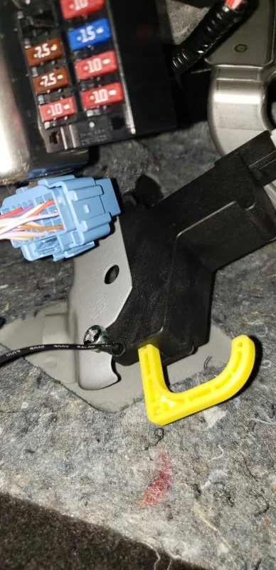

You’ll want to use slots 2 (ACC wire) and 18 (BATTERY wire) in the driver’s side footwell (under the steering column to the left) which are both empty.
Is the 2 slot always on in your car? When I put the fuse in the 2 slot the camera would only come on when the car was running or acc turned on.
Also any metal body part can be used as a ground right? I couldn't get to what you showed so used the one below. The ground is connected to the screw next to the yellow handle
Also any metal body part can be used as a ground right? I couldn't get to what you showed so used the one below. The ground is connected to the screw next to the yellow handleView attachment 5086
That Yellow Handle looks very important - perhaps an ejection thing, or to put the Clarity into Hyper Drive Mode? What is it really for?
The yellow handle is the ejection seat handle for "backseat drivers". Also acts as the manual charging door release.
