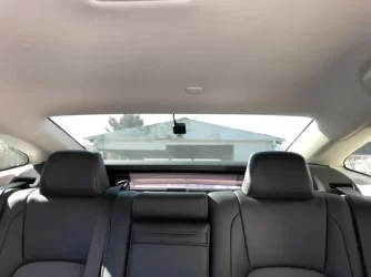

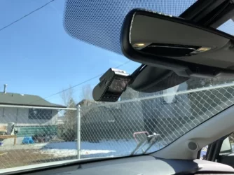

Thank you so much for your detailed instructions and pictures. I actually have this exact same camera to install in my Clarity. If I may ask, how did you route the rear cameras wire (it’s quite thick)? Also, do you have any picture of how the camera looks mounted?

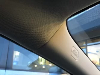

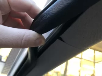

I wonder if you could take some pictures of how you routed it around the A Pilar to avoid interfering with airbag deployment....
I got some feedback on this on my post on Reddit. It’s pretty tight and running the wires (for the hardwire line and the rear camera) behind the airbag is a bit tedious but it’s doable. I was rewiring my incorrectly wired install so I ran the cable from the door frame under the airbag toward the camera (not from the camera, under the airbag, toward the doorframe as I indicate in the instructions) and I managed to get it. The included cables have some chunky parts (ferrite core and the USB connectors themselves) that require some nudging to get through. I feel like coming from the other side (across the headliner to the pillar and under the airbag) would be an order of magnitude more difficult because visibility would be practically 0.

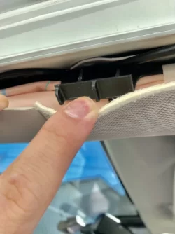

This is the best picture I could get of the wiring under the airbag at the seam between the headliner and the pillar of the driver’s side door:
Excuse my fingernail. The plastic in these parts is treacherous.
No problem! I figured if I’m going to do the work I might as well share with others. Despite the rear camera’s cable thickness, I didn’t experience any real difficulty with the process. There’s ample room along the trims to tuck it away. In fact, I have both the rear camera cable and the hardwire cable running side-by-side across the headliner to the camera with room to spare. Here are some pictures showing the cameras installed:

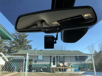

Thanks for the write up. Why did you put your camera where you did? I was plannng in putting it on the dots, with the the lens just below the dots

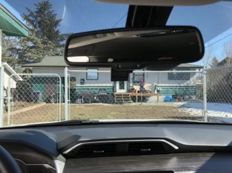

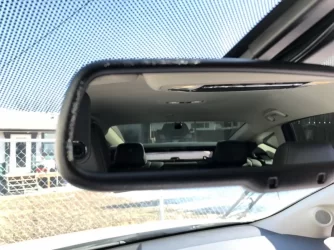

I placed it there for a handful of reasons. The first is that I didn’t want to stick the adhesive to the dots should it, in the future, create some sort of trouble for me (if I tried to remove it and it peeled off the dots or left adhesive goo between the dots or what have you). I also wanted to make sure that it was going to stay adhered to the window (you can feel the dots on the inside of the windshield and it just made me concerned that it might not be as secure there). Additionally, I like to have my dashcams aligned so that there’s about an inch or so or the car’s hood visible in the footage for reference. Placing the cam where I did framed footage optimally for my preferences. And finally, with where I sit in the car (given my height and seat alignment preferences) having the camera where it is lets me see the lights on the bottom which indicate if it’s recording or not. Not a huge thing but sometimes I like to glance at it for reassurance.
Hope this answers your question! If you have any others, let me know.
I put my camera where you want to, on the dots with the camera just below the dots. That was 18 months ago wit no problem having it stick. We get extremely hot weather and freezing in the winter.
I wanted it to be as hidden as possible.
