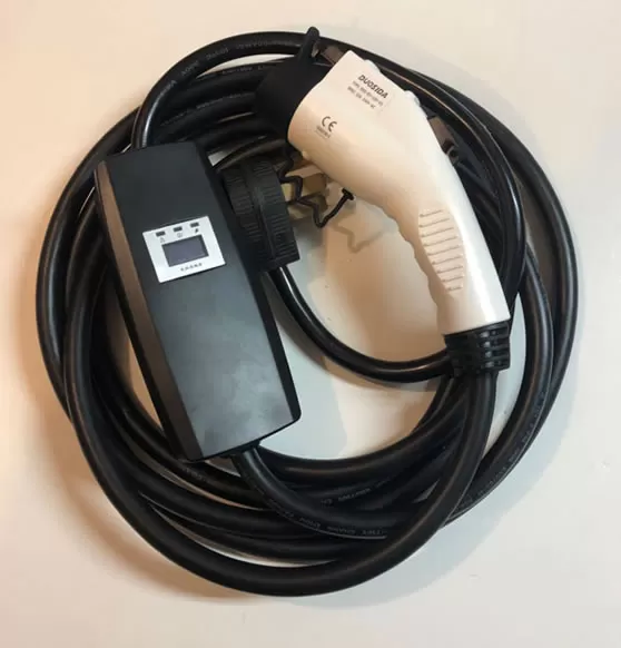

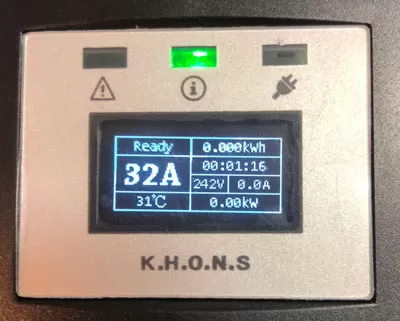

I've never heard of this compact, versatile $315 Chinese KHONS dual-voltage EVSE until I saw it on a Tucson, AZ, EV equipment vendor's site. On 120 VAC it can output up to 12A, on 240 VAC it can output up to 32A. It comes with a 14-50, 240 VAC plug and the vendor can supply a 120 VAC adapter. It includes a display. My $800 EVSE doesn't have a display! To eliminate the need for an external knob or switch, it has you shake it from side-to-side 3 times to select 12A, 24A, or 32A operation, which I thought was both clever and funny.
Reminds me of the regular maintenance instructions for the Commodore Vic20 and 64 computers: Pick unit up over solid table or surface approx. 3 inches, and drop. (because they didn't want the expense of machined IC sockets and went with cheaper spring-loaded ones). ((hello fellow olds!))
A lot (but not all) EVSE will operate over a wide range of voltages. The level one EVSE that came with my Kona will also run on 240 volt and put out twice the wattage. I also have and older GE level 2 EVSE that while designed for Level 2 (240 volt charging) will also operate fine on 120 volts. I have tried this on both units. In the case of the level one charger which I keep in the car in a pinch using an adapter I can double my charge rate. If I am traveling or camping and a 30 amp 120 volt trailer plug is available (NEMA TT-30) I can use my Level 2 to charge on 120 volts and 30amps (actually 24 for safety reasons ) and I get 2.8 kw of charging. Adapters are available for most EVSE. If your curious check the upper and lower voltage limits in your EVSE manual
What I found exceptional about the KHONS EVSE was that an EVSE this small could deliver 32-Amp Level 2 service. I found this 2017 review from someone who purchased this EVSE at full price and recommends it.

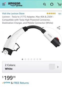

Anyhoo, when cleaning out the totaled car, I, of course, kept the Tesla portable connector. It's small, powerful, and has interchangeable plugs that tip the unit off how many max amps to draw, based on the outlet they are plugged into.
Since I'm already sold on the Tesla -> J1772 converter, I'll get another for my car. That will be nice because many hotels have Tesla "destination" chargers (Level 2) in their parking lots, for free.
