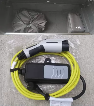

It has just a 120 Volt plug. You would have to have an adapter to plug it into a 240-Volt outlet. Nothing on the charging cable or in the manual indicates it works on 240 Volts, but others have said it will. I just took my charging cable out of the boot for the first time (see below).
It took a while for someone in InsideEV's Honda Clarity Plug-In Hybrid thread to be the guinea pig, but that charging cable proved to work on 240 Volts.

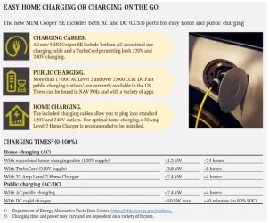

At one point MINI had an image posted on charging, and was planning to include a 240V "TurboCord" that could handle 3.8kW. It might be this product, which costs as much as a Level 2 EVSE.

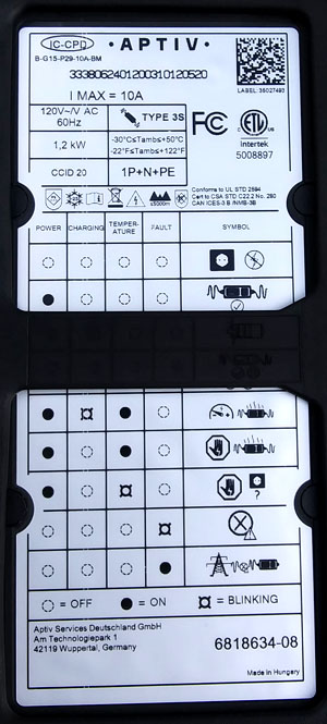

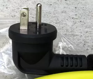

Not like a Tesla charging cable. The plug is molded onto the cord. Here's the label on the bottom and the plug:
I can't believe it never occurred to me to look at the cable. Looks like 120V only, maximum of 10A. So a 240V adapter isn't going to work.
I was disappointed the SE draws a maximum of 15A for Level 1 (1.8kW) instead of 20A. But to see the included charging cable is limited to 10A (1.2kW) is worse, that's not even the maximum rate of the vehicle.
Now I'm going to have to search for a better Level 1 cable. 1.8kW is 50% faster charge than 1.2kW!
I'm going to put our Clarity Plug-In Hybrid's 12-Amp Level 1 charging cable in our MINI Cooper SE. I'll have to make a 240-Volt adapter for it, even though I don't know when I'd use it. This InsideEVs Clarity forum thread discusses the 240-Volt operation.
To bypass all the early doubters (including me) and get right to @Mowcowbell's report of plugging his Honda Level 1 charging cord into 240 Volts, go here.

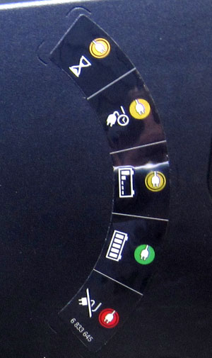

Before my SE arrived I wondered what that sticker was on the inside of the "charging socket lid" (as the Owners Manual calls it). It's a cryptic depiction of what the color of the LED to the left of the charging socket means. The black circle inside the colored circle indicates the LED is flashing. I haven't tried plugging in the charging handle without plugging in the charging cord to an AC outlet, so I haven't observed the LED flashing red. I'll let you guess what each of the pictograms mean (that way I can't be wrong--see page 223 in the Owners Manual for a description of the LED's meanings).
