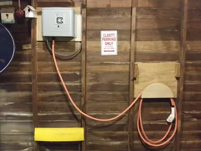

In the UK, public EVSEs connected to 3-phase AC can pump 11 kW into the SE, but my "future-proofed" single-phase 48-Amp/11 kW ClipperCreek EVSE can't charge my SE any faster than the 7.4 kW a 32-Amp EVSE can. In addition to over-spending, I ended up with a very thick, unwieldy 48-Amp charging cable. On the plus side, the giant relay in my really big (mostly empty) EVSE makes a very satisfying THUNK when I plug in the charging cable. To our MINI Cooper's disappointment, our Clarity Plug-In Hybrid called dibs on our 1-car garage 3 years ago (and posted a sign to ensure there was no confusion).
A overarching motto in my life: 'no kill like overkill...' second to that would be 'it's better to be looking at it, than looking for it.'
I don't think overbuying on the charger is a waste at all, and if anything, by running something at less than it's max, you tend to build in a bit more reliability.

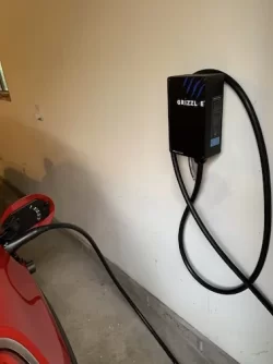

Level 2 EVSE is up and running, the major electrical upgrade was worth it. Hardwired 7.7kW EVSE (32A on a 40A circuit) in addition to a 50A 14-50 outlet elsewhere.
I feel free to drive now, since I can get a full charge in a couple of hours instead of the 12+ it takes with Level 1 charging. No more being stuck in Green mode!

@Puppethead - What drove the decision to convert your EVSE to a hard-wired installation?
Electrical codes, my state requires GFCI on all 240V outlets. EVSEs all have their own GFCI and generally don't work on a protected circuit, so the only way to pass inspection was go hardwired. I don't consider it a big issue, it's easy enough to disconnect from the wiring.
I briefly considered looking at OpenEVSE to see if I could build my own without internal GFCI protection, but decided I wanted to be up and charging as soon as possible. I also chose the Grizzl-E largely because of the cold weather tolerance, -20ºF is normal for our winters.
Okay, that's what I suspected. Thanks!
