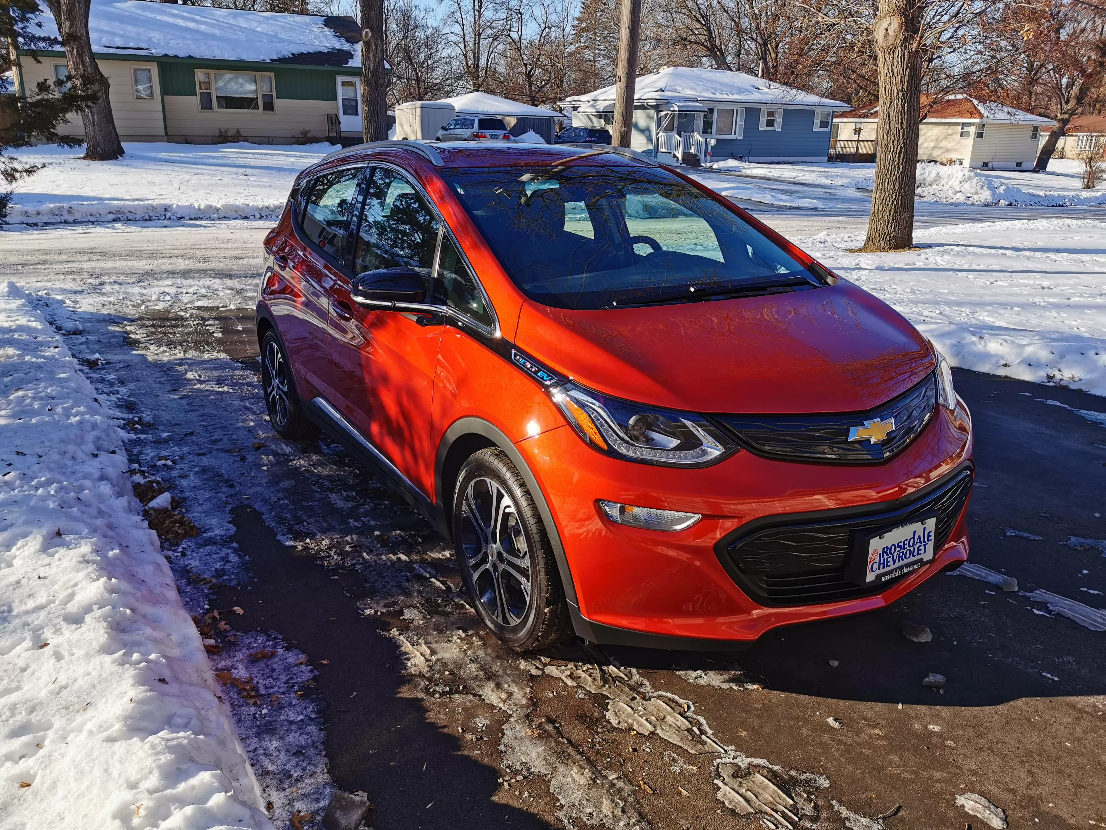

Final Update:
Hyundai has bought the car back. Unfortunately they weren't able to fix it.
This is my new ride now:
I hope you recovered your costs from Hyundai for the inconveniences. Nice looking Bolt, that was my second choice but I just couldn't get comfortable with the seats.

They gave me back full price including taxes paid for the car. The bolt is quite nice. The seats are not the best but the car was over 13k less than the kona so I can live with that.
I'm glad you finally have some resolution, enjoy your new car it looks pretty sweet.

Sorry it did not work out. I had a Bolt for 3 years. Great car. I particularly liked the 1 pedal driving. Some folks complain about the seats. I was perfectly happy with them. I turned in my 2017 Bolt for a 2020 Kona SEL. Also a great car. So, enjoy. The Bolt should serve you well.
