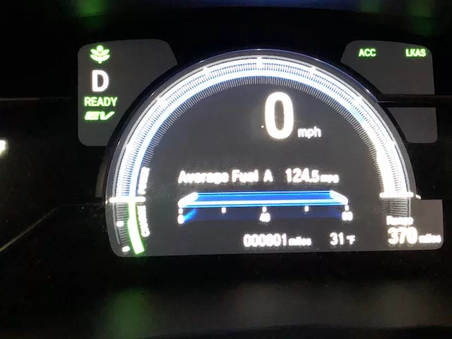

  1. I don't know how accurate the Clarity's own gauge is, but this is the 801 mile report (tried to catch "800" but too slow) - ALSO, remember, I am a reformed Prius owner with a pretty light touch on the accelerator and brakes, to the point my own children deride me as "great-grandpa"
  2. Outside of the two highway trips (40 miles at 75mph and 190 miles at 75-80mph) these are city miles generally between 30-60mph
  3. Weather has been mostly 40-50 degrees, with exception of two very cold 3-4 day sessions of 20-30 degrees
  4. No doubt in my mind that cold (and we aren't even talking what many of you suffer through) has a BIG impact on range/performance
  5. Noticed a strange incident in both cold snaps - the cars engine would come on for about 5 miles then go EV BUT the gauage showed no blue range, only white, while the output screen showed it was running on battery only (I could not hear any engine noise) and had to turn car off and back on at a red light and gauge started registering EV only again (blue)
Thoughts: number 5 worries me because it is a software issue similar to the random killing of SXM radio when you use the Climate Remote - have to reset the software to regain accurate reporting.
I have a lot going this week, but I am going to try to contact Honda corporate to ask them to set up a forum or something for registered owners to report issues and comments - unlikely to get much traction but worth the effort. In the meantime, perhaps we should start a new Issues/Comments thread for JUST reporting issues, with no discussion allowed (keep that in the current Issues thread)?

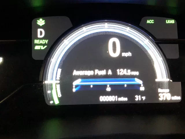

1. Regarding the fuel economy gauge...based on my observation it only measures efficiency of the gas engine. It does not take into account use of electrical energy in EV mode, so we have to manually calculate this based on our kWh usage (as reported from our L2 home/public chargers), and convert kWh to a gallon of E10 gasoline using the conversion 32.78 kWh/gal. Since it is very likely most if not all Clarity owners would charge up many times between fill-ups, we have to sum up our kWh usage, convert that to gallons of E10, and then finally add in the gallons of gasoline at fill-up to come up with the most accurate mpg-e. The car's mpg figure would only be useful in HV/HV charge modes.
4. I totally agree that the cold has a big impact on range/efficiency. The vehicle's estimated EV range, as reported on the infotainment system and on the Hondalink app has been dropping during the cold snaps. It makes sense, the car has to generate heat using heat pump and/or resistant heating since it doesn't use the inefficient/heat producing gas engine to heat the cabin.
5. I have not observed that particular software bug. Based on recommendations from an EV site on cold weather driving, I use ECON mode exclusively when the outside temp is below 50F. The gas engine hasn't come on but one time during these recent cold snaps, when I briefly got on the turnpike at 75 mph. I have, however, experienced the SXM freeze up. It wasn't until I read thru this thread that I learned it may be tied to the Remote Climate. This issue isn't consistent though, the previous 2 mornings after using Remote Climate I have had no issues with the SXM radio, but the previous 2 days before that I did experience the issue.

As for the other questions:
1. The whole MPGe model is baffling to me. In 801 miles I have used 6.3 gal gas (@$2.54/gal) and 174 KWh at approx $0.12/KWh. If I assume I've used about 8.2 "gallons" of electricity, for a total of 14.5 gal - does that mean I have a 55.2 MPGe? Really good, but not outstanding.
5. I have not been outside Eco mode other than for the longer trip to Pecos (190 miles). The SXM cut-out issue is random for me as well, EXCEPT it never happens except in conjunction with Remote Climate.

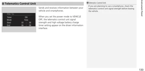

Now to Hondalink. I've been wondering this myself. I think the car has a cellular data connection. Check the speedometer/gauge display after you turn off the car. It displays a cellular tower with several bars with some abbreviation like RCM or something like that beside it. Check to see if there are any bars displayed. If so, it's still connected to some cell network somewhere. Whatever it is, it is very cool.
It's the smartphone, the Telematics Control Unit (TCU) (which is a thing, who knew? Google it)

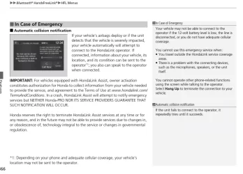

The other indication of no cellular (don't know for sure, but seems to be the case, especially based on our reduced HondaLink feature set) is the optional setting that lets the Clarity use your cell phone to call for help (maybe the hondlink operator?) if the Clarity detects an accident. (see bottom of page below, "Depending on your phone ...")
