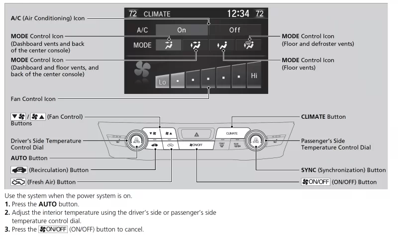

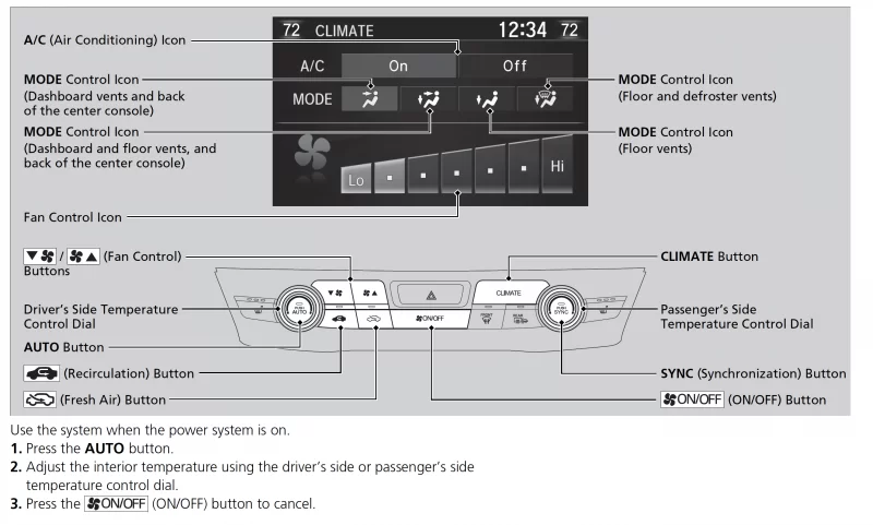

This is a shot in the dark, but might be worth a try: Check this climate page and check "OFF" for A/C: (also, at least on the iPhone Honda App, the app gives the cabin temperature during climate pre-conditioning.)
On my Clarity when the climate is set to automatic those functions are not available for selecting. The car determines all of the settings, you just give it a temperature.
Ah, still may be worth a try to confirm A/C is off, but I just noticed that in "AUTO" both of the climate page A/C buttons go off ... (PHClarity2018 just posted this too, thanks)

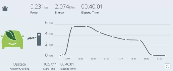

Here is a sample chargepoint curve (32A EVSE charge chord) for a climate pre-condition cycle from 26F ambient to about 75F cabin temp:
(unplugged it and plugged in again just before 11am to begin a new graph, so it took a little power for something before the climate cycle began. It was plugged in prior to that.)
