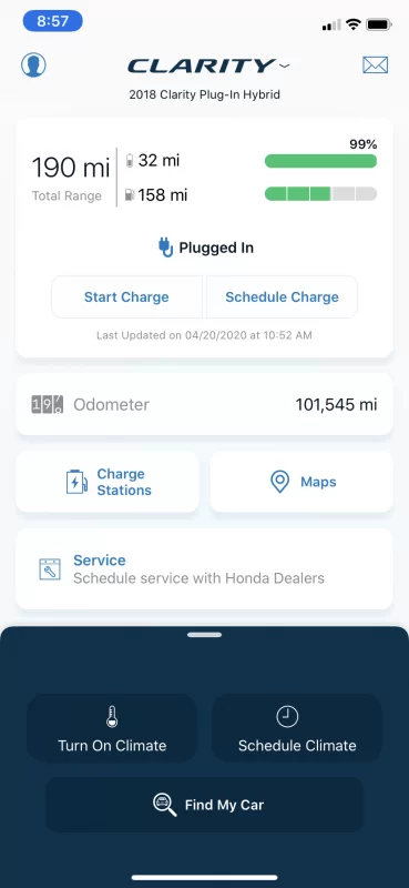

Mine has been dropping. Look. 32 miles now. It’s been about 24 all winter.
It’s 38⁰ now. But last week when it was 70, it wasn’t much better.
