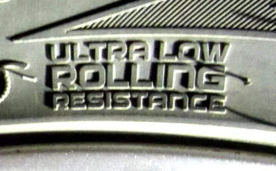

This comment motivated me to do some Google-based research on whether you take a mileage hit with winter tires. The data out there is miles per gallon, but the effect is the same as our EV mileage. The results were fascinating. I found results that varied from people who claimed to get 11 miles/gallon less with winter tires to people who said that their mileage actually improved when they installed them. I couldn't find any data from the manufacturers themselves, which suggests that switching to winter tires probably reduces mileage. I suspect it's a much smaller factor for our EV range than temperature.
I attribute my EV range reduction to the effect of colder temperatures on the battery, the current drain of the Clarity's resistive heating devices, and the slushy stuff through which I must drive. My Nokian Hakkapeliitta snow tires probably can't match the fuel-efficient performance of the OEM Michelins, but they do say this:
