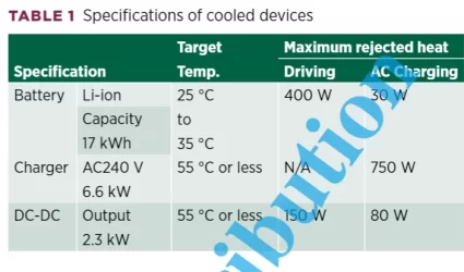

Finally, the DC-DC converter rating (what charges and powers the Clarity 12 volt system) is now finally known at 2300 watts max (is fussed at 175 amps) so a sustained 13 volt draw down will likely blow the current limiter/regulator. We also know the real rating of the HV charger, it can only charge the battery at 6.6kW not 7.x. It is dissipating any additional current as heat and noise. See attached spec sheet from SAE Honda doc (no, I don't have a subscription, hence the watermark).

Thanks @Cash Traylor . That validates what we’ve suspected as to the converter’s efficiency being about 92%. In that 6.6 kW / 7.2 kW (what my EVSE reports) = 92%. Thanks again for adding some more metrics to our understanding of the Clarity cause Honda sure ain’t helping.

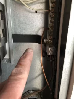

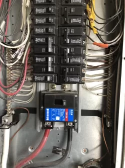

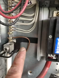

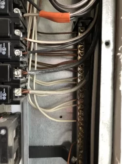

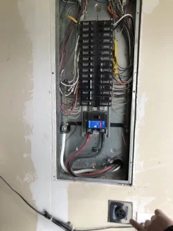

Also @The Gadgeteer may be interested. I know I beat this to death already, but I did another install today for a customer of a 6-50r receptacle in a garage (not for EV, but for a pottery kiln. Though if she or a future homeowner ever goes EV, this can also be used for L2 charging). Opportunity for a few clear photos of neutrals and grounds all mixed together on the bus bar, and also the bonding strip that connects these 2 bus bars. This is a correctly wired service panel.
This configuration would be INCORRECT for a sub-panel, however. Had this been a correctly wired sub panel instead of a main service panel, one bus bar would be all bare grounds, the 2nd bus bar would be all white neutrals, and the black bonding strip between the two bus bars would not be installed in the panel. This would isolate the grounds and neutrals from each other, as it should be in sub panels only.
Photo 1 just an overview of this very simple install. The outlet I installed today is immediately below the panel where I'm pointing, just for ease of wire fishing. Customer wanted least expensive location possible and this couldn't have been easier. In and out of the job in 1.5 hours start to finish, purchased $35 in materials including outlet, breaker, wire, box, faceplate, connectors, etc.
2nd 2 photos show mixed grounds and neutrals on both bus bars.
Last 2 photos show how the bonding strip connects the 2 bus bars together even though they're on opposite sides of the service panel from each other...making it one continuous bus bar (bonded).

In addition to the electrical specs in the table on page 2 of that document, there's a lot of fascinating technical information in it. Well worth the $37.
I came across a technical puplication that lists the output of the DC-DC 12v converter at 2.3kw. it is cooled by the same loop as the battery and charger. That would mean pulling 2kw off the 12v battery would be no issue. Also interesting is that at AC charger is listed as outputing 750w of waste heat.
