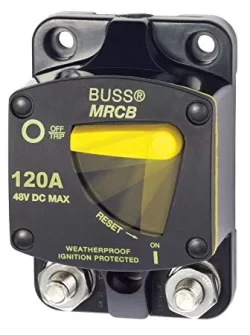

random google picture of a MRCB type breaker:

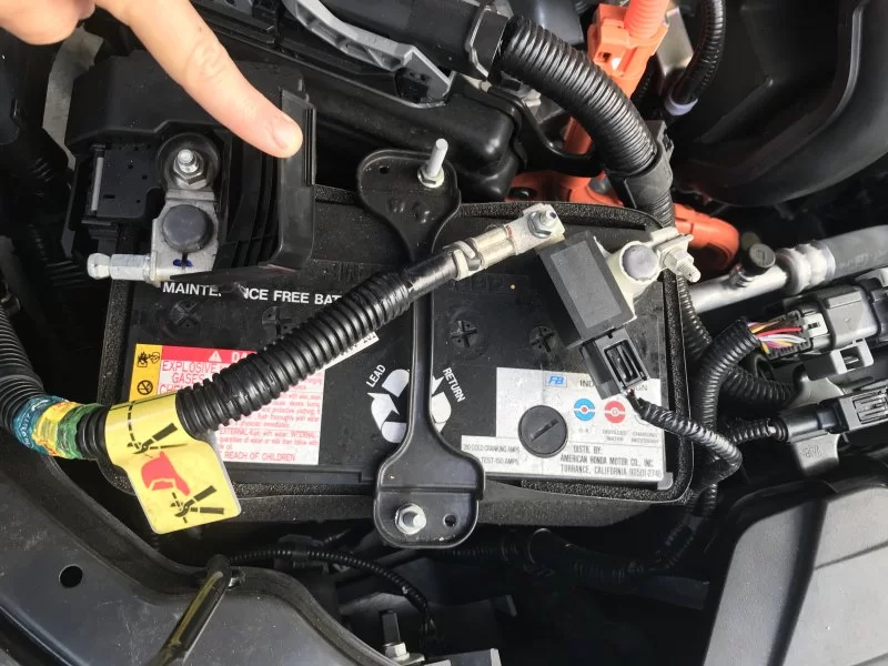

Hi Ho Silver - What battery terminals did you connect the inverter to? There’s only one terminal on the positive side, and so that’s obvious, but the negative side has 2 places to connect up to:
1) as bolt that tightens the clamp around the battery post, and
2) another bolt that attaches a large wire to a plate connected to the post. But in between that other bolt and the battery post is a mysterious black box with a small wire connected to it....almost looks like it’s a sensor of some sort.
See attached photo.
Dave

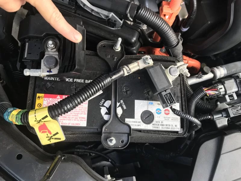

See attached photo.
DaveView attachment 8040
I would connect your inverter after the ELD(black box) this will allow the car to see the load and increase the power from the dc/dc converter and step up the voltage a little.
Could there be an issue running high continuous current through the ELD?
I could not find the exact model that Honda is using, but a similar model states that "The use of such a low-value shunt should permit the IBS unit to operate at a current range of ± 600 A continuously and ± 2,000 A in pulsed applications not exceeding 900 J"
You really should not continuously exceed the rating of the onboard DC/DC converter as that would drain the small 12v battery quickly. The sensor should be rated for at least the capacity of the converter and probably more. Also being on the opposite battery side of the eld the only current it will see is the difference of the converter and what you are pulling from the 12v with battery your inverter which should be a small amount or short surge currents.
Also, the current loads and thermal status of the DC-DC converter is a CAN buss monitored unit with DTC logs both live and "frozen." If you exceed the ratings and it fails - I doubt it would be covered under warranty. There is no normal load that the 12 volt system nor battery could create that would consume 2300 watts for anything more than a few minutes (the battery would blow). So you get 170 amps max depending on system voltage. The battery system is fused at 175 (however that is for charging the battery only, so the distribution of that load is likely planned at around 140 amps. Just a note of caution, as the Clarity is a really expensive generator compared to other options. The DC-DC converter is $1350 on it's own, and if you blow it and trip the immobilizer, you might also have to pay the towing to your dealer for the repair. Each to his own... I like the idea and have done it with the small 1000 watt inverters. However why anyone would consider attaching a large inverter that pushes all the limits of what is normally a very low 12 volt system demand in this car is confusing. Honda monitors the Clarity well, the telemetrics system gathers an amazing about of CAN data. Anyway, if you are in a tough spot an need power, from anywhere and this is your "plan B" if you real generator quits, then I fully get it. However to PLAN to use this at more than 1000 watts continuous for any duration is likely unwise.
