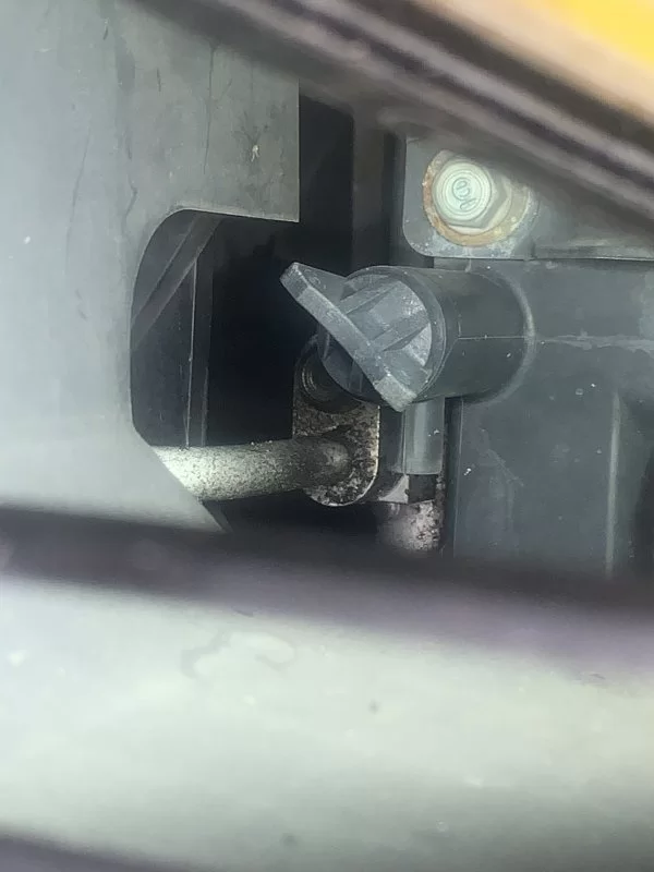

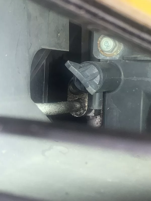

Receiver pipe leak. Since this is my third leaky condenser, including the original one with the car, I got some sympathy but I'm still out more than $700
, and have to wait for the part to ship from California to Massachusetts which is expected to take six business days. I'm planning to contact Honda itself to see if I can get a reimbursement for some of this because it's hard to believe that tube didn't get atypical wear/handling since it's connected to the condenser. And it's an extraordinarily unreliable AC experience so far.
Receiver pipe leak. Since this is my third leaky condenser, including the original one with the car, I got some sympathy but I'm still out more than $700View attachment 21253 , and have to wait for the part to ship from California to Massachusetts which is expected to take six business days. I'm planning to contact Honda itself to see if I can get a reimbursement for some of this because it's hard to believe that tube didn't get atypical wear/handling since it's connected to the condenser. And it's an extraordinarily unreliable AC experience so far.
Since you've had multiple repairs on the same problem, maybe you can get your money or settlement through the lemon law. I think it's worth a try to contact a lawyer!
