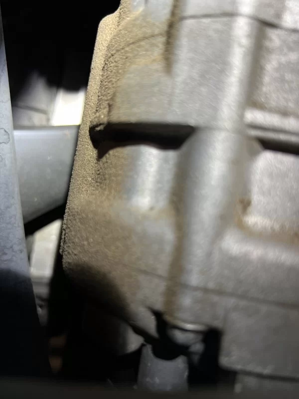

Update: the car was supposed to be fixed by today, but the dealer guy just called to tell me I have to wait another day (at least) "because that Clarity AC is very complex and different from the others, not the typical Honda stuff", and it takes the lead mechanic, who is the only "Clarity certified" in the dealership to fix it.
Still wondering why did Honda chose to put a "very complex and different AC system" that also fails frequently.
The dealer guy is probably your service advisor. He told you what he believed you were capable of understanding. Your compressor needs to be replaced. The compressor in the Clarity is driven by electricity as opposed to those on an ICE vehicle which are driven by a belt. So the guy who’s been issued the special gloves and safety goggles has to do the work.
Take the service advisors words with a grain of salt. All air conditioners work on the same principle of moving heat from one area to another. If you really want to know, ask him what makes the A/C system “very complex and different”. He’ll probably be at a loss for words.
What fails frequently is the condenser coil. We’ve seen very few failures of other A/C system components.
When I called, I found out the service advisor called sick today, and the lady in his place told me that "Honda sent them the wrong part, but the right one is coming tomorrow early in the morning". We'll see. Not that I've been very lucky with the Honda dealers outside of CA. I regret to admit I should have sold the car before moving out...
I am sure your drive back to hell will be fine. The million dollar question is how long it will keep working...Finally got the car back today! Compressor replaced and car tested exhaustively for one whole day to make sure there were no more leaks. Only costed me $100 thanks to HondaCare extended warranty, otherwise it would have been $3400... Now the real test will be on Sunday, when I'll be driving back to hell... I mean, Phoenix...
