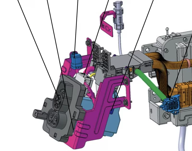

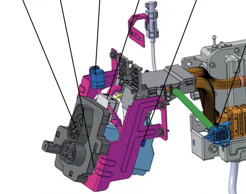

Looking at the docs it's clear that the port itself is not mechanically or electrically connected to the door assembly. Not unexpectedly, it appears that they procure the port as a standard assembly and the body designers provided the opening in the bumper to access and protect it. The port is attached to the front metalwork while the door is fitted to the inside of the urethane bumper.
The door assembly including the door, door-closed sensor, lock, timer override button, LED charge level indicator lights and the illuminated multi-color ring are all CAN controlled from what's effectively the body control module (IGPM). The port actuator is also hard-wired directly to that along with a sensor which I'm assuming detects the position of the plug lock actuator.

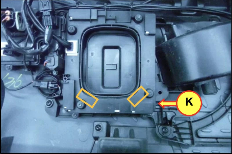

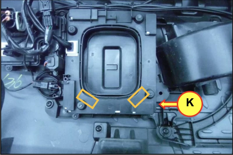

But more relevant to the thread, the issue with the door not opening that is addressed by the TSB relates to the fact that the door must be pushed in slightly to release the rather-cheap push-to-lock/push-to-release "ball-point pen" mechanism. The TSB provides for ensuring the clearance between the door opening and the port face (with caps installed) is sufficient. Perhaps the caps were an afterthought and took up some of the designed-in clearance?

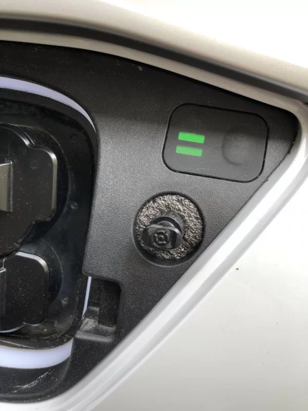

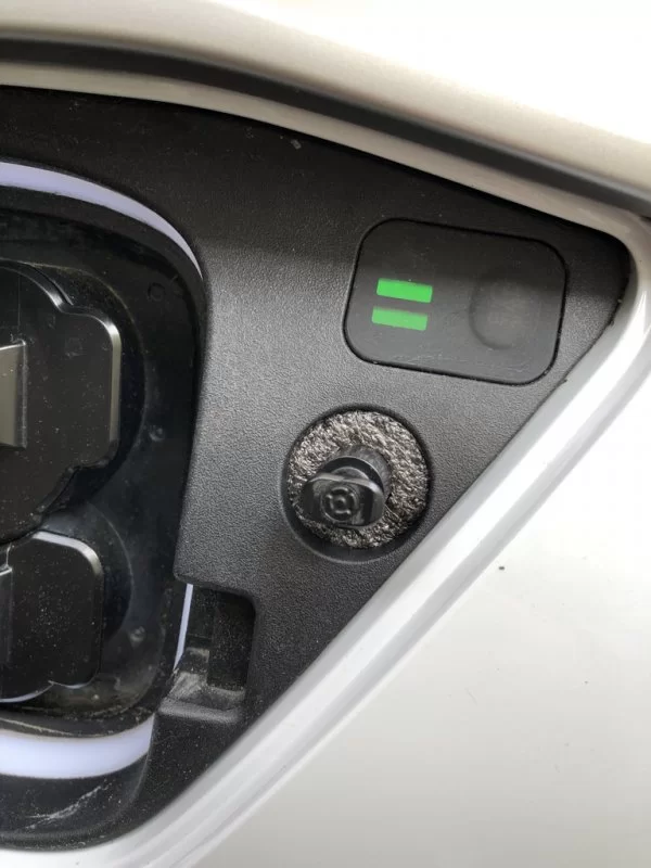

I'll see how this goes at keeping water and dust out. 5mm thick closed cell foam.
Looks way better than what I have been using on the lid, and more functional, had to reroute the weather stripping as it wasn't doing the job. Hard to tell by the picture if the foam is round or dimensional also does the door close without undo pressure on the plunger latch and it rotates without resistance?
The polystyrene closed-cell foam is exactly 5m thick and may have been used to hold ICs or such. I just used some sharpened 13.5mm OD tubing to "die-cut" the hole and scissor-cut the outside to a concentric circle. 1/2" copper water pipe might be about right.
It crushes when the door is closed, you can see that the receptacle on the door fits partly into the recess.
It's just an experiment, will see how well it holds up.

The Hyun. TSB 20-BD-002H is supposed to fix the problem. It adds 2 vinyl pads to bottom of housing but requires removal of front bumper to get access.
