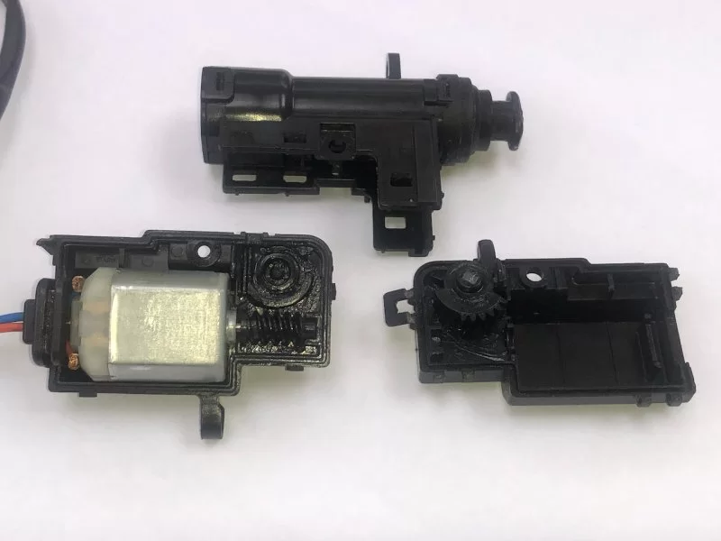

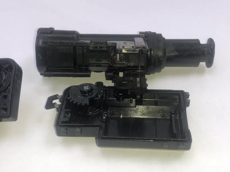

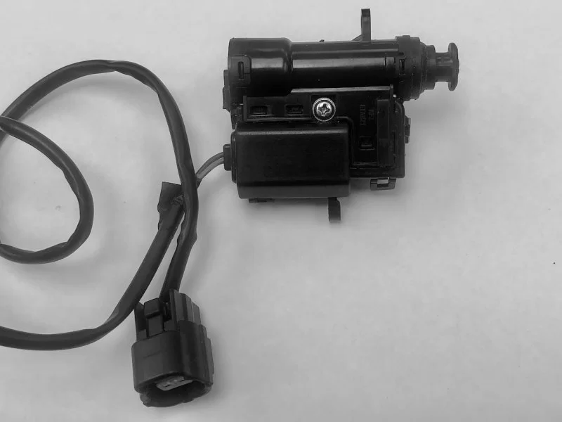

I've pried it apart, and can see how it works. There is a motor with a worm on its shaft that turns a quadrant that moves a rod up into the plunger "ball point" shaft and locks it. I'll see if I can take some pictures that show that. Regarding dissasssembly, my father used to say when I was frustrated taking something apart "Well the manny put it together, so you can take it apart". He would not have approved of me breaking off the plastic tabs to open it up!
Good description - makes sense. Pictures would be a bonus.
Was there any debris or dirt that you noticed, cracked plastic gears, possibly actuator relay contacts corroded? Maybe do a 12V test on the motor to see if it fails under some load.

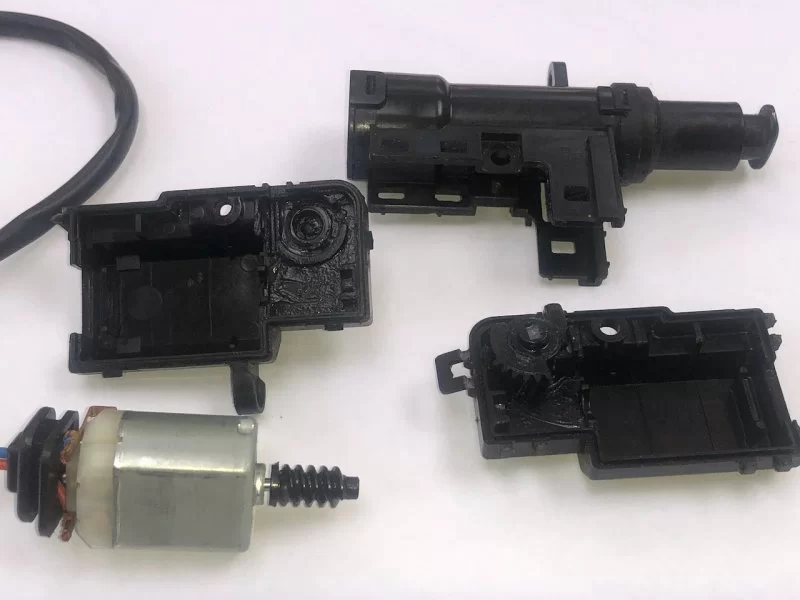

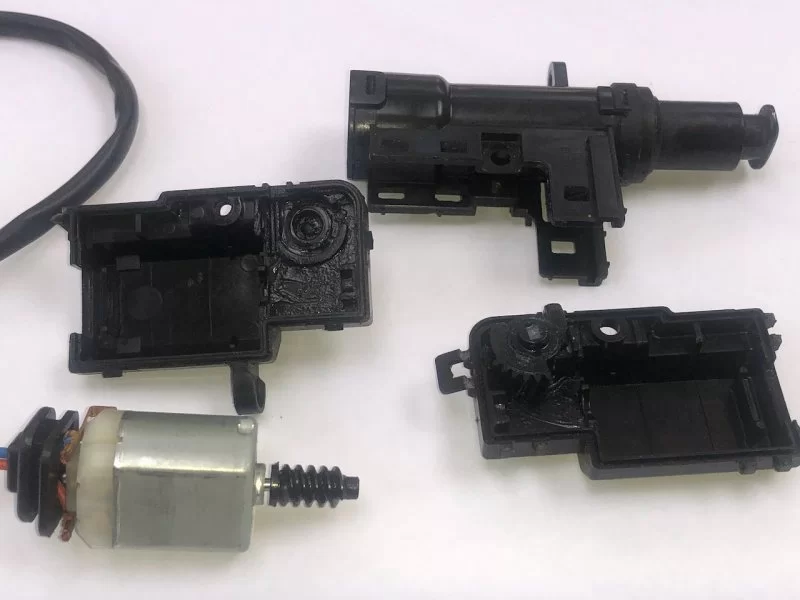

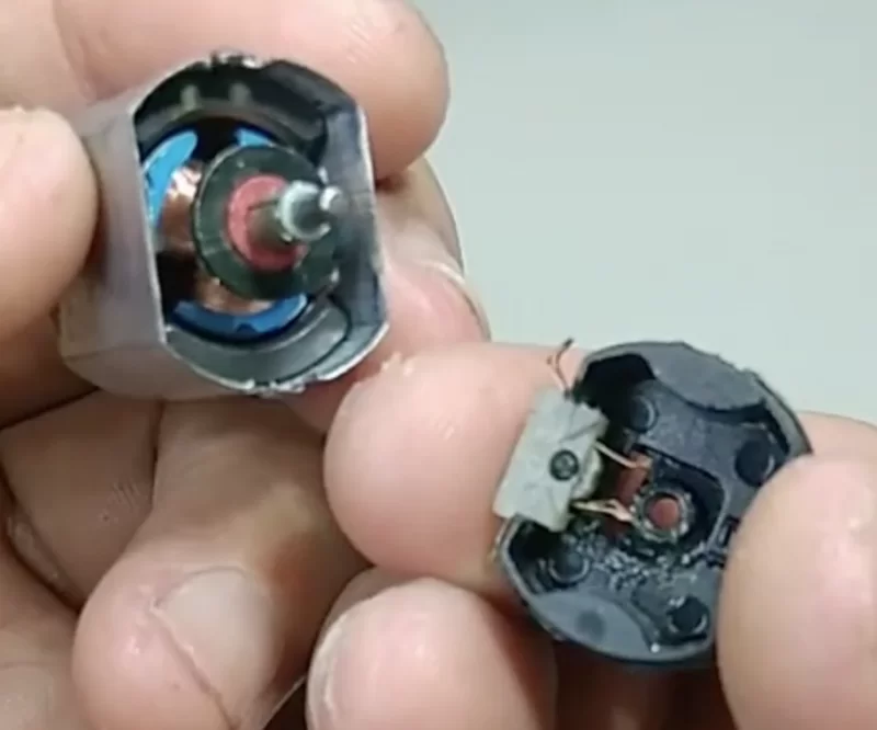

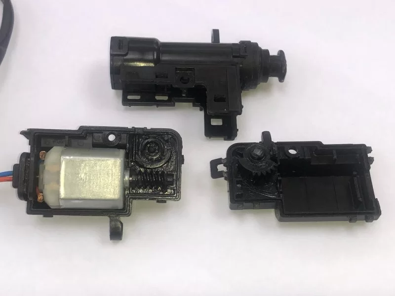

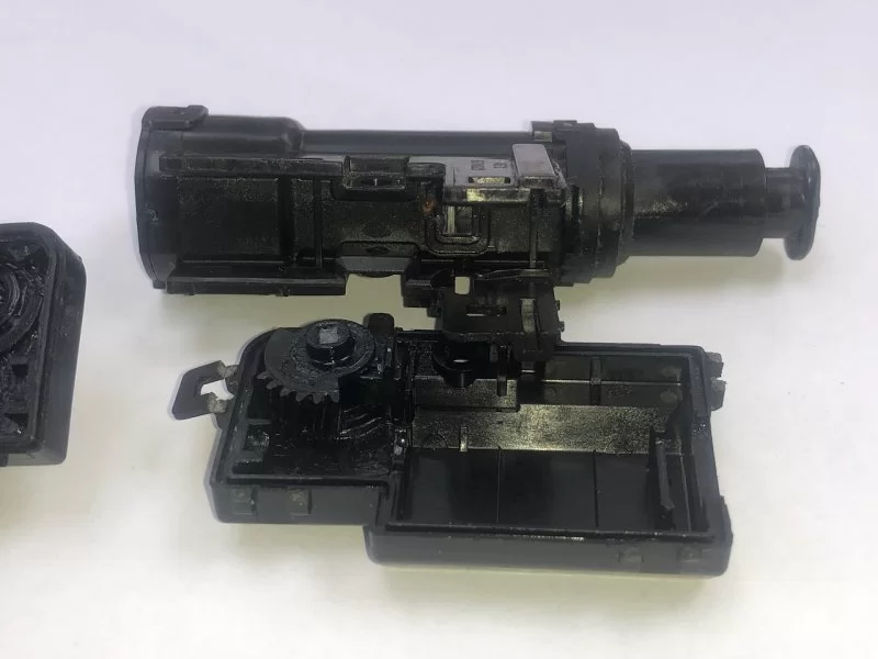

Here are some pictures. I hope they are self explanatory. You'll see that all is clean inside, and there are no cracked gears and no contacts. The motor turns freely in both directions when 9V applied, though I haven't re-assembled the unit to see if it drives the locking pin/rod. It can only take a couple of turns to move the locking pin so I wonder if that is done by a very brief electrical connection to the motor. There is nothing obviously broken. So the actual cause of it not working remains unknown.
Here are some pictures. I hope they are self explanatory. You'll see that all is clean inside, and there are no cracked gears and no contacts. The motor turns freely in both directions when 9V applied, though I haven't re-assembled the unit to see if it drives the locking pin/rod. It can only take a couple of turns to move the locking pin so I wonder if that is done by a very brief electrical connection to the motor. There is nothing obviously broken. So the actual cause of it not working remains unknown.View attachment 21885 View attachment 21886 View attachment 21887 View attachment 21888
Possible misalignment of the plunger within its limited travel in the housing? Hard to tell. Maybe take the plunger housing apart and try to create a problem - look for scratches or debris first.
Appreciate the photos...so far
Here are a number of thoughts and observations.
This charge door locking actuator may not be specific to our Konas. It is somethiing that could be applied to fuel filler caps, glove box doors and the like on other vehicles. Although the paper label on my defective actuator is unreadable there are numbers moulded into the plastic - KF2 ETABZ1. So it is possible that there is a body of knowledge about what causes them to break down if that are very many in the wild.
As to the plunger of the actuator, it moves freely. There is neither debris nor scratches. Initially it takes about 600 grams to move it in, rising to about 900 g as the spring compresses, and then to 1200 g to make it "click" and stay in the closed position. As the plunger is pressed in it spirals 90 degrees anticlockwise, so that the lugs on the "daylight side" of the plunger can engage with the catch on the inside of the charge door. When in the clicked closed position a cavity in the barrel is available for the locking pin to enter. It is a loose fit. However when in the cavity the pin gets in the way of the plunger when it is pushed in to "unclick" it.
For the unlocking itself then, the motor needs some electricity to turn the worm to rotate the toothed quadrant to move the pin back out. With everything else seemingly in order, what is unknown is why the motor does not start to turn on occasion. A prime suspect is electrical connection inside the motor - do these things have tiny commutators and brushes?
Having said all that, I think I'll now saw the end off the locking pin, or remove the quadrant entirely, and reassemble the actuator. If the new one ever fails, it'll be replaced with the original in its new never lock mode :)

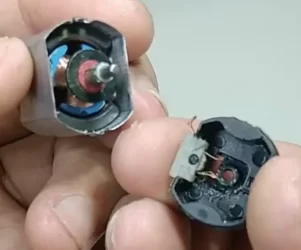

Yes, that appears to be a conventional brush commutated DC motor. If you connect an ohmmeter to the motor and rotate the shaft very slowly you can check for any high resistance spots on the armature that would cause it to fail to start, much like what happens with ICE starter motors. That situation is traditionally overcome with a firm blow from a hammer.

A problem that might be occurring with this design is that the motor brushes will land on the same locations of the commutator at each of the lock and unlock positions over the thousands of actuations demanded over a few years. When a voltage pulse is applied in either positive or negative polarity the current spike on the motor before starting and after stalling at the end of motion could cause erosion on the commutator at those spots. Eventually the resistance may be high enough so that the motor occasionally does not respond. I would expect the IGMP drive circuit has some means of current limiting to minimise this damage but it also has to supply enough current to start all the motors in all temperatures and load conditions over the expected lifetime.
That theory would also mean that it's somewhat equally likely that the door could fail to lock as randomly as it fails to unlock. Of course no one is likely to notice if the charge door opens when it shouldn't.
