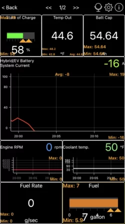

Page 1 has the @lincomatic & @MrFixit posted the instructions on how to enable the battery capacity check through adding a custom PID. Or you can download the whole set posted by @MrFixit on post #44, it's a backup of his setup including all the custom PID for our Clarity. Thanks again to both of those guys!
I think you are supposed to use the "Dashboard" in CarScanner to monitor things.
Here's my setup, captured while pulling into my home from work. I charged to 80% at work this morning, one way is about 10.5 miles. (I use an iPhone so it's kind of hard to get the files off.)
