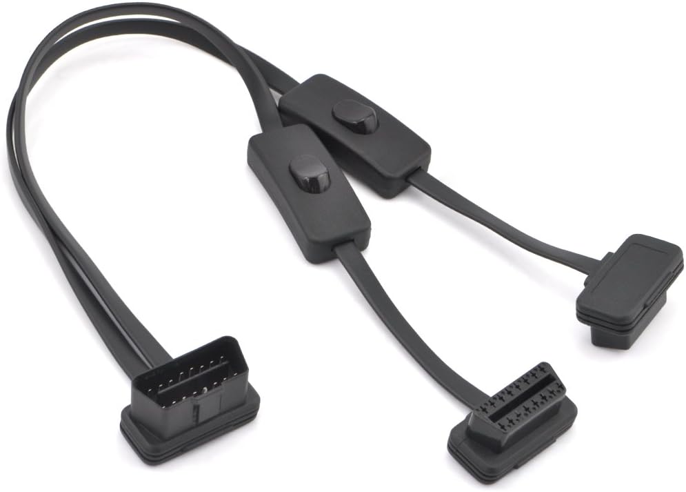

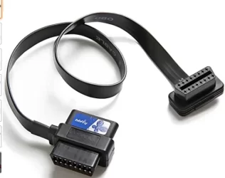

Turning off the deep sleep function can save some wear and tear on the car's OBD2 connector. I don't think you have to worry about battery drain if you drive the car regularly, but if you let the car sit for over a week, it's probably a good idea to unplug it, or turn on the deep sleep.
Also, there's the issue of security. If you leave it plugged in an it's on all the time, anyone who's in its vicinity can connect to it, and change its settings. I don't think they can hack your car, however, since the CAN bus is turned off at the OBD2 port unless the car is turned on.
Personally, I have a y-cable, and am going to leave that connected to the car. That way, I can unplug/plug the device in when I need it repeatedly, w/o worrying about wearing out the OBD2 connector.
Maybe I'll get a $13 ODB Y splitter cable and mod one end of it so it gets power from ACC on, and leave the other one for normal operation.
Please let us know where the nearest ACC power is located, if you end up doing this. I will probably go the same way.
