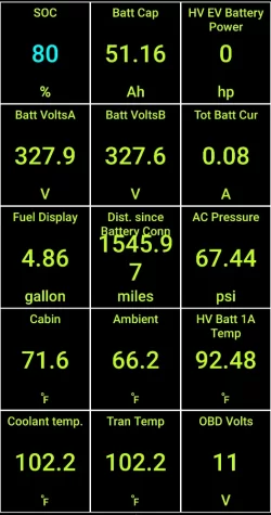

Finally got my vGate. I find it hard to believe my battery capacity is this high. I can't get even 40miles in EV mode. Im averaging around 2.25-2.40miles/KWH.

Finally got my vGate. I find it hard to believe my battery capacity is this high. I can't get even 40miles in EV mode. I'm averaging around 2.25-2.40miles/KWH.
Right - Your battery is definitely not that high. The battery capacity measurement on your vehicle has certainly been 'reset'. Over time (it may be a significant amount of time) it will gradually return to reading a true capacity. We do not know details of the algorithm that is used, but it depends on your driving / charging habits as to how quickly it will reflect the true capacity.
If you just drive short distances and don't deplete the battery very much between charges, or if most of your miles are long trips on the highway in HV mode, the capacity measurement will probably take a long time to re-adjust. If you regularly deplete the battery and do frequent full charge cycles, it will re-adjust more quickly.
I suggest that you monitor the capacity on a regular basis (maybe every month, depending on how much you drive) and track what happens over time.
BTW - 40 miles in EV more is not 'bad'. There are 2 big factors that substantially reduce range. First is using heat in the winter (likely not the situation now). Second is speed. It is pretty easy to get the rated range (47 miles) driving around town in the summer at speeds below 55. There is a big difference on the highway - if you are going 65+ you will have a substantial reduction in range. Air conditioning recuces range a little but not nearly as much as heating.
I deplete my battery down to 1 bar just about every day to work then charge to full at work. The majority of my driving is on the highway so I'm sure that doesn't help, I'll keep an eye on the capacity.
I did just buy the car from a Hyundai dealer so maybe they reset the capacity (car has 111k pretty hard to believe I have that much capacity).
Thanks for the info

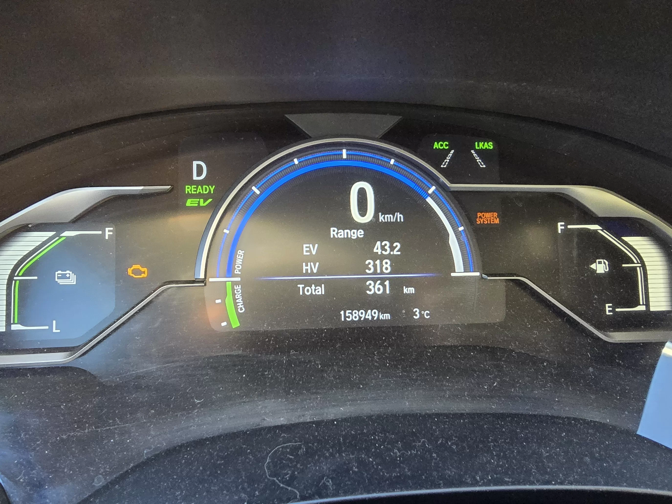

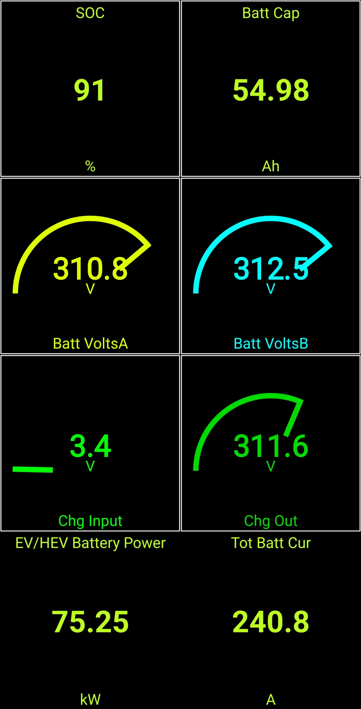

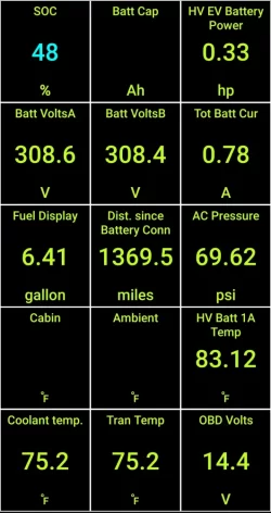

My 2018 Clarity (~159,000 km...1,000kms away from the battery warranty expiry) just popped up a CEL and POWER SYSTEM warning on through dash. Connected to OBDII and codes P1DC7 and P0A7F came up (Hybrid battery pack - deterioration). Brought it to the dealership and 2 days later, they said they cleared the codes and come back if the error reappear. They stated that's Honda SOP.
The weird part is the battery range is much higher and battery capacity jumped from 42Ah, measured a few weeks ago, to 55Ah. Thanks to your post, I'm waiting for this to stabilize.
Run the car out of gas, and let the battery drain to zero. That battery is shot, just need to give it a few more kicks.
