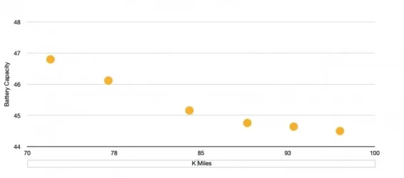

I thought I should share my battery capacity graph. At 72k miles in May 2023 I finally got the OBD reader. Through 84k miles I was simply charging it to 100% every time I charged. After that I decided to try to charge it to only around 80% since I didn't need the full capacity most of the time. That turned out to be hard to do manually, so around 86k I bought a mechanical timer (for the 120 volt charger) so I could easily go to whatever percent charge I thought I would need, usually between 70-85%. If I need 100%, I charge to 85 then plug in to the 220 volt charger a half hour before I leave. It may sound complicated but its really not hard at all after awhile. Here is my graph, it does show a significant reduction in capacity degradation when I switched charging methodology. Hopefully this is not just happenstance and it continues at the low degradation rate.

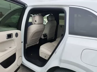

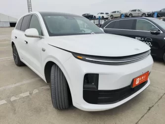

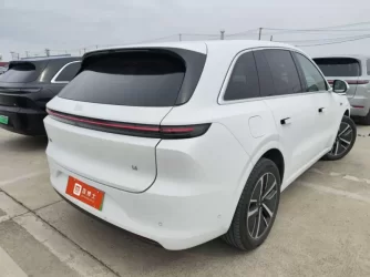

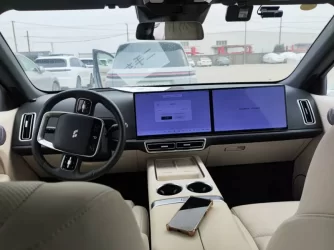

Hi its me again with my statistic)
Also I installed Solar Panels for my home and since february I charge using only solar))
Clarity its very good car, but time to change it to something on very very high level.
Purchased from China Lixiang L6 Pro (2024 36Kwt LiFePo4 battery CATL + 1.5Turbo generator)
Its very interesting car (just look on a price for new one) with LFP battery. Its better than Li-Ion

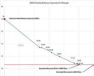

As I approached 100K miles on my Clarity, I started measuring the battery capacity more frequently. It appears that the battery degradation curve is flattening out and will not get down to 36.6 by the time the Honda factory warranty ends at 100K miles. The extended 120K 6-yr warranty I bought does not specifically state that it covers the Li-Ion battery in my car, so I have to assume that it will not cover a replacement. In addition, I know there are no new replacement batteries in stock, and the wait period for a remanufactured battery is undetermined. I'm also uncertain how well the car will perform (or if it will even continue operating) as the battery degrades further. I'll attach a graph showing the capacity measurements.
Anyway, I decided to be proactive, so this weekend I drove from Phoenix to Mission Bay Chevrolet in San Diego to trade in my 2018 Clarity with almost 99K miles for a 2020 Clarity with about 25K miles. It's the same base model with the same pearl white exterior and beige interior. So I now own practically the same car, just 2 years newer with 74,000 fewer miles on the odometer. The car was overpriced, and my trade-in was underpriced, but with the $4,000 tax credit (which is going to go away on Sept 30 because of the so-called "Big Beautiful Bill"), I now have a newer Clarity for about $10K out of pocket. The battery capacity on this 2020 Clarity is 47.8 Ah - not fabulous but a lot better than 37 Ah.
I don't know how the Honda warranty works, but I sincerely hope that whoever buys the 2018 vehicle from the California dealer will be able to benefit from the 150K 10Yr warranty that California offers. Does anyone know how that extra long warranty works?
Well, you were so close that it's not funny. I might have leaned on the dealer / Honda to make a warranty claim...
You clearly like the Clarity and found another solution to keep the dream alive !
