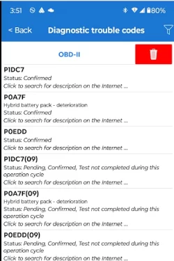

Here's the quick and dirty version. 2 weeks ago I started my car and every light came on but the car would not start. Assuming a dead 12v battery, I jumped it and it fired right up. After about 5 miles of driving I got a check engine light and an error stating that I could not change the "drive mode". Upon arrival I have OBDII errors codes of P1DC7 and P0A7F (hybrid battery pack deterioration).
I brought the car to the dealer with no agenda. Just with the note that the check engine light was on and the circumstances leading up to it.
After about 48 hours it was clear that they were struggling to diagnose the vehicle. That's when I provided them with the PDI, the warranty parts list, and my current battery capacity (38.8) compared to the warranty threshold. 24 hours after that they said that they said that all this points to the battery needing replacement and they started down that path.

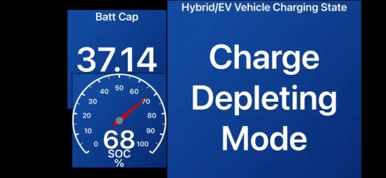

My 2018 Base Clarity is at 93,787 miles with a battery capacity reading, using my ELM reader, of 37.14. According to this forum, it seems that the warranty replacement limit is 36.6. Even in mild weather here in Phoenix, I normally only get about 32 miles of EV range. I've only ever charged with the OEM L1 charger, but charge almost every night.
It's going to be an interesting race to see if my battery drops below the 36.6 threshold level before 100,000 miles. Is the ELM reading likely to be any different than the reading that a dealer would read (assuming that I can get a dealer to check the battery capacity for me)?

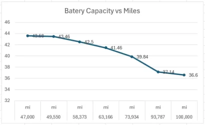

Here's a chart of the decline in my battery capacity vs. mileage up to my most recent reading at 93,787 miles. For reference, I inserted the 36.6 warranty value at 100K miles to see how that data point would fit the trend. If the capacity keeps declining as it has recently, I may just qualify for a warranty replacement after all.
It does seem to both my wife and myself that the ICE turns on more readily now even when there is EV range remaining, as if the threshold for using the ICE power during acceleration is lower than it used to be.

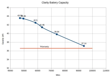

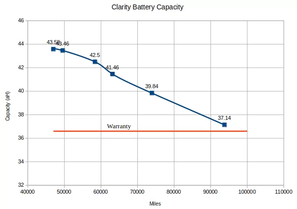

The number of miles between each capacity measurement varies quite a lot in your case. If the chart doesn't account for this, it can sometimes fool you when trying to interpret a trend... So, I re-plotted your data with a more accurate scale on the X-axis:
Even plotted this way, it sure looks like you are headed toward a warranty situation. It will be close, but even if you don't quite make it, I think you have a very strong case and you should fight for it. The fact that you have this data which clearly shows the progression may be valuable if you find yourself in a dispute.

Thank you for taking the time to replot the data. I'm amazed at how linear the battery capacity decline looks when plotted correctly.
