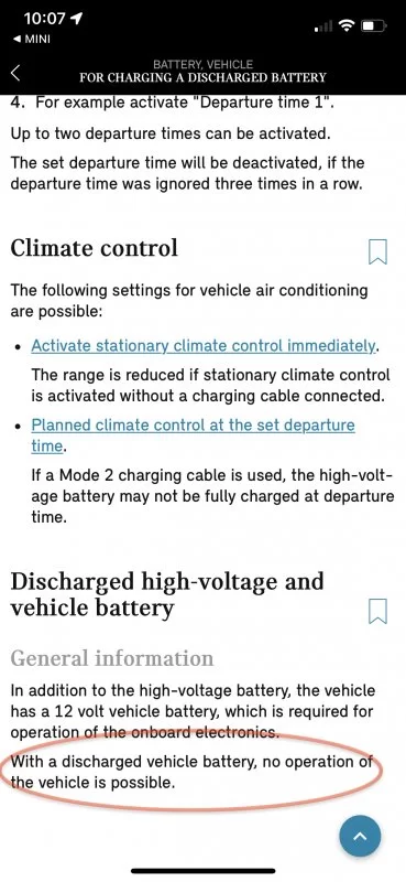

Per the Motorer's Guide, the SE won't run without a 12 V battery. But who knows if that's simply holdover language from the ICE guide.
It could be simply some kind of short term provision so that all user settings are not lost when changing out the 12v battery. Until someone’s SE ages sufficiently for the 12v battery to demise, we won’t really know what happens when the 12v battery fails.
