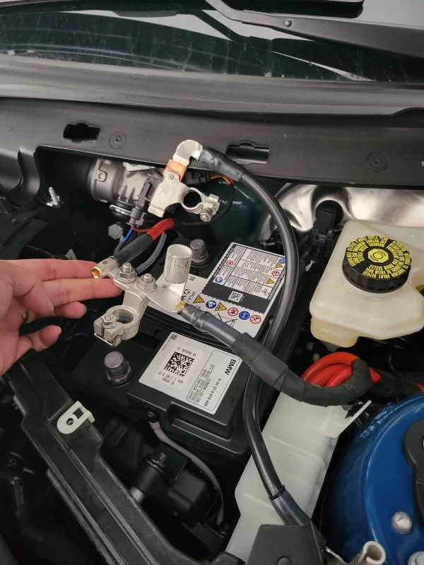

I disconnected both terminals off the 12v battery, and....nothing! The car still starts up, all the electronics still work, AC still broken! What?? Ill upload a picture of the terminals off the 12v battery. Maybe there's a fuse box I can access?

I accessed the fuse box in the glovebox and pulled every fuse related to AC and fan and defrost, the only one I didn't pull was fuse 5 which is in the body domain controller, still nothing. I'm going to try to access the BDC to get at fuse 5 to see if that will reset things. Pulling the leads off the 12v battery did absolutely nothing. Everything still worked fine, which was weird.

How long did you leave the 12 V battery disconnected? It may need to be disconnected for some time for the car to discharge accessories, maybe 30 minutes?

Disconnecting for 30+ minutes might help, as might the ENET cable, but I fear that it will take something like Esys or the dealer to sort it.
Yeah I think it was disconnected for about 30 minutes. Didn't time it. Car functions all seemed to work weirdly. I'll mess around with the ENET cable. Really unsure about esys because it's such a new model, not even sure which module to download/how to do it. I'll see if I can contact that user.

Really hoping so, just waiting for responses on all the other forums I posted on. I did read other places that even with gas mini f56, pulling the 12v doesn't reset the ECU, so I think pulling the leads off, removing fuses, etc really was pointless and that it really needs a recode.
