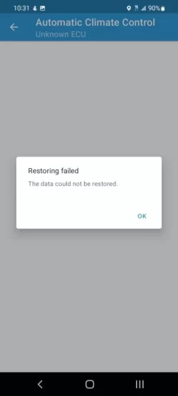

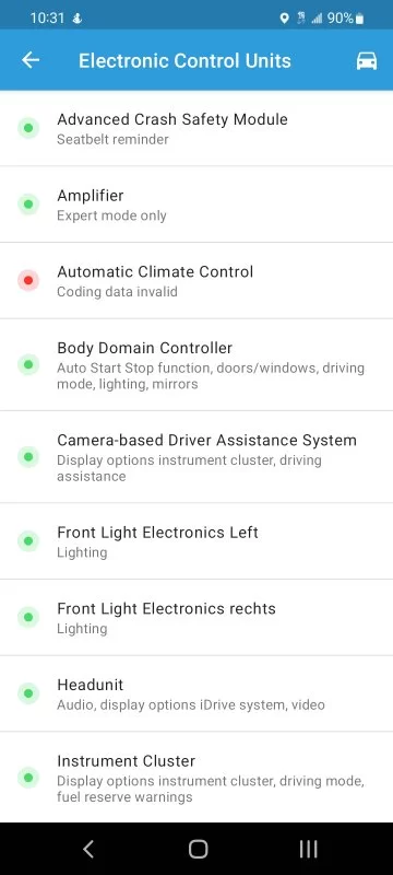

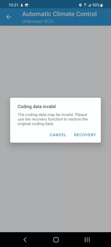

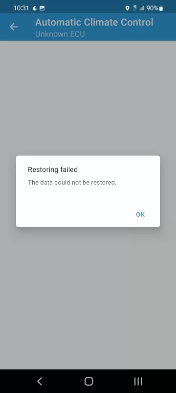

Hi guys, not sure if I did something unfixable, but I've been using Bimmercode to change a lot of things in the car, no problems. Today went to the automatic climate control ECU and when I coded the change (turn off automatic air recirc) there was an error while coding. Now all I see is the defrost button continually flashing with the defrost going continually (even when I turn off the AC and turn off the car). Can't turn it off and it's just constantly going...tried to restore but can't do it. This is what I see. I tried reaching out to Stephan through the Bimmercode service button and so far all he's said is to turn off all Bluetooth connections, restart phone and unplug Bluetooth connector (veepeak BLE). None of this has worked.
Does anyone know how to fully turn off the car and reset? I'm thinking that maybe turning off the car completely and on again might make it so I can at least restore the backup in Bimmercode.

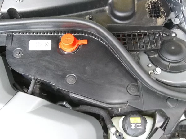

Anyone know how to even do this? Not sure where the 12v is located.
Look under the hood for the red cap with a + on it. It appears you'd have to remove 3 bolts to get underneath the battery cover.
Edit: The more I think about it, your changes are probably saved in memory so a battery reset is probably not worth attempting. I thought Bimmercode saved the original settings so you could put things back to OEM before taking the SE in for service.
I removed those 3 bolts and realized that the plastic piece is actually attached to the much bigger plastic trim that's around the entire top/front near the windshield of the car. The best I could do was slightly lift it up to see the battery. On the positive terminal there's several different things attached to it, which look intimidating and not at all something I should unscrew. I couldn't even see the negative terminal because it was deeper/further back.
In addition, I actually removed those two bolts further behind (you can see in the picture) and still couldn't lift it off. it appears that i have to remove the entire trim piece with all the different plastic pieces to take it off? or maybe I'm just not doing it right..
I know the changes are saved in the memory, but for some reason bimmercode won't recognize the ECU so that I can restore the memory.. If you look at the pics I attached above, that's all bimmercode says, which is coding data invalid, then when I click on it, it says coding data invalid, recovery. Then when i click on recovery it says restoring failed, data could not be restored...
