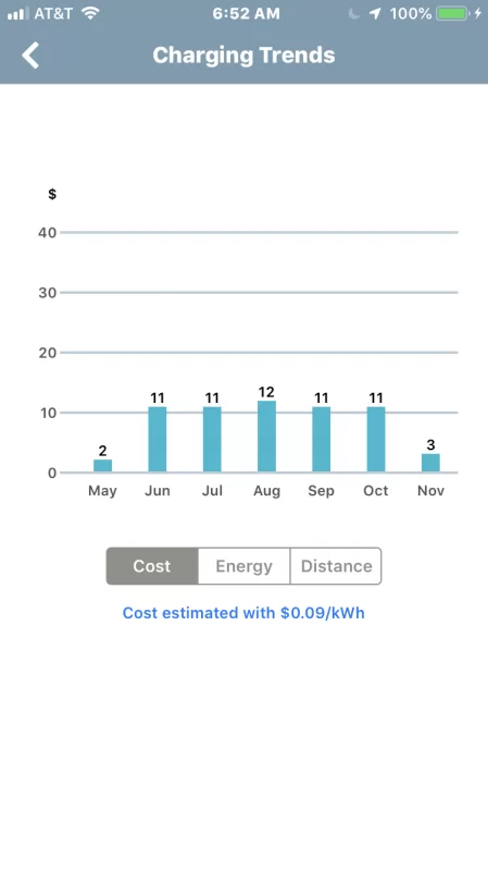

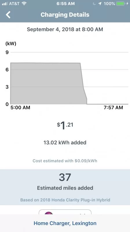

For just $50 ($450) more you can get an open box/never installed ChargePoint on eBay (32 Amp, 25 ft cord) from a reputable US company with great customer and technical service 24/7. It’s UL and Energy Star certified. That’s what I did. This unit has WiFi and an app that shows usage per charge and per month over time in both kW and cost. It automatically found my utilities cost per kW and reports that for me. Links below. It also can set a charging schedule easier than the one in the car. It’s a high quality unit you can trust. And it comes with a great manual that’s not been written in Chinese and translated into pigeon English. The app will give you the documentation you need to keep your condo assoc happy. PM me if you want more details.

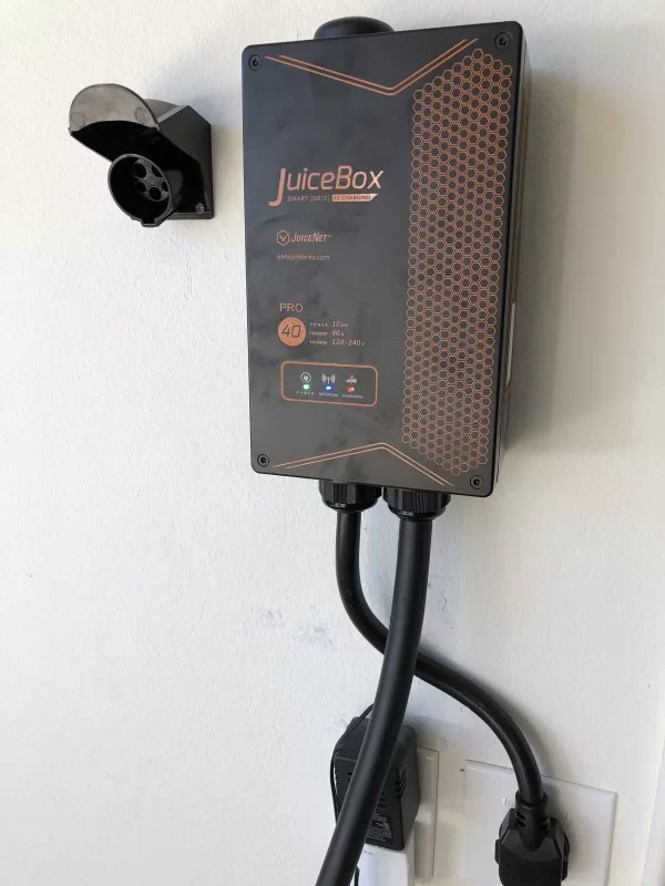

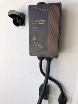

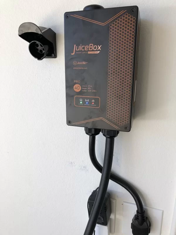

Just had a Juicebox Pro 40 set up in my garage, hooked into my WiFi network and already charging my Clarity. Couldn’t be happier with it!

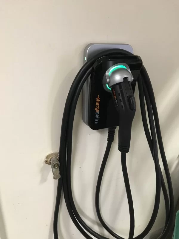

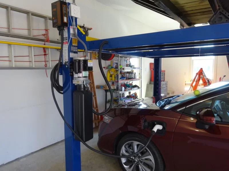

Happy for you, but my Charge Point Home can beat up your Juicebox (just saying)...well at least until either of us gets a car that can charge at 40 Amps from the wall. Then my CP will have to quake in fear since it’s only 32 Amps. But it’s a real looker compared to the clunky Juicebox.
Here’s my baby with her comforting green pulsing glow that lets me know every time I pull into the garage that she’s ready to rock.

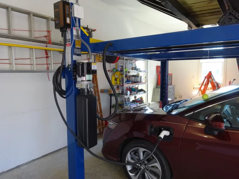

Industrial utilitarianism has its appeal, but the ChargePoint is just a beautiful small footprint design. However, I would trade it in in a heartbeat for a Juicebox if your garage and lift came with it. I’m green with envy. All I’ve got is 4 jackstands and a floor jack. Sigh...
