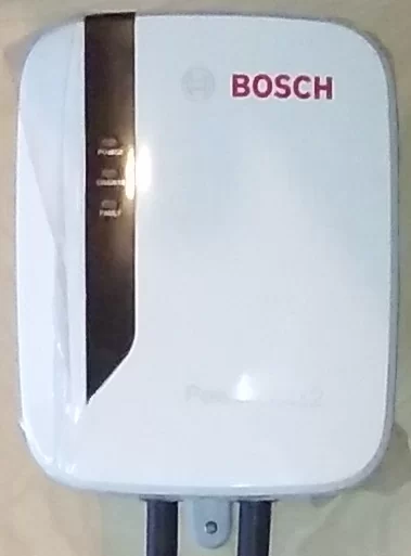

I don't believe I've read any other poster report they have a Bosch EVSE. I put 60-amp/240-volt service into my garage right after Honda announced a 50-state Plug-In Hybrid (and 2-state Electric) would join the Fuel Cell Clarity. Then I bought a Bosch 40-amp plug-in unit last November because I've always liked Bosch products (even though I believe this EVSE is manufactured by someone else) and because I plan to buy Honda's first 50-state EV whenever they get around to selling one (I've written letters trying to convince Honda to sell the Urban EV in the US, not just Europe). This EVSE's only features are an on/off button and 3 LEDs, but charging has never been an issue.

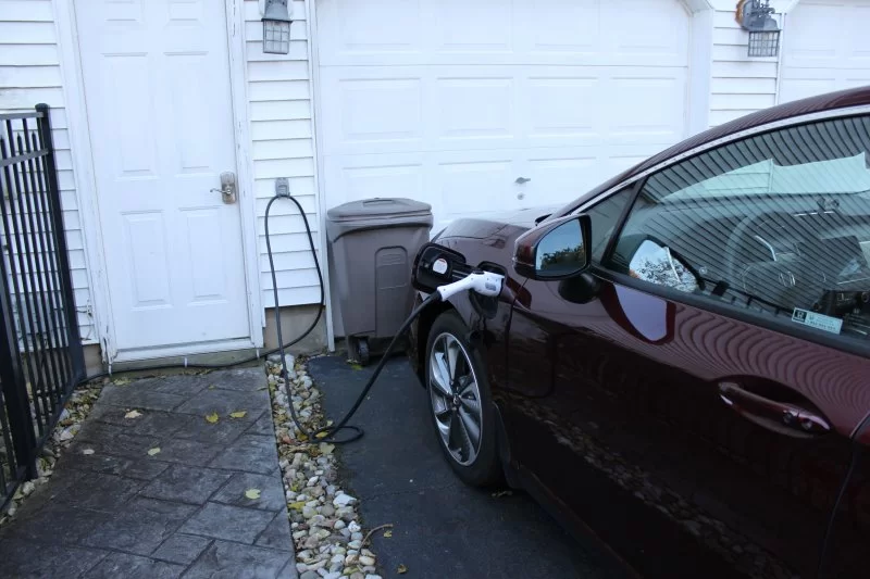

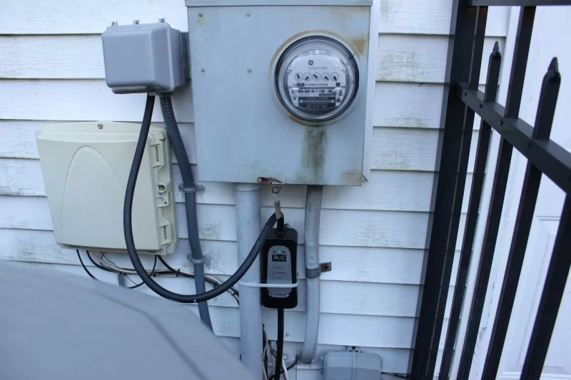

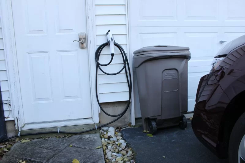

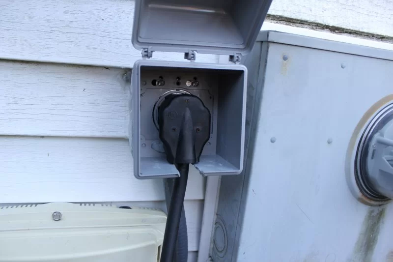

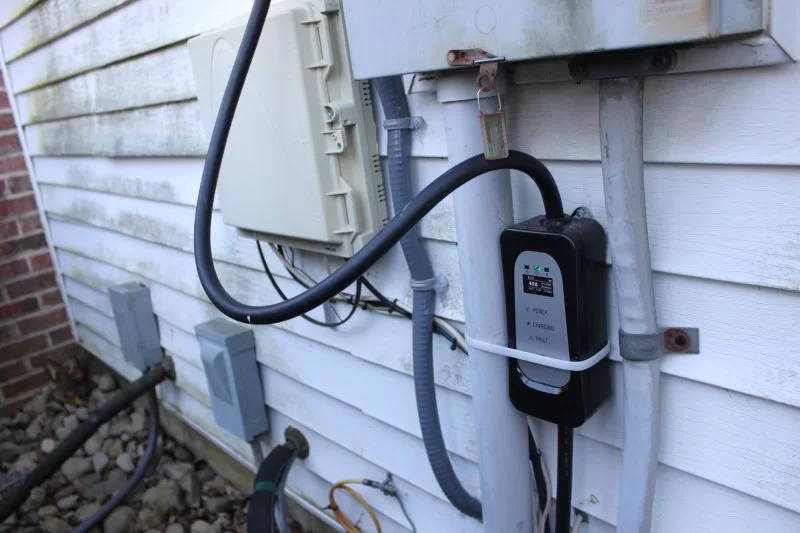

I bought this one: https://www.amazon.com/gp/product/B077D5C86M
It's reliable so far. I actually had it installed outdoor, plugged into a 50 amp NEMA outlet (gauge 6 wire and 50 amp breaker). The EVSE only draws 32 amp though since Clarity charger inside the car only calls for 32. The EVSE can handle up to 40 amp, however.
How is this holding up outdoors? The Amazon description is very interesting as it says don't use it in bad weather or even if it is raining. I have been charging with the OEM charger in heavy rain without any issues. Wondering if Mustart is just protecting themselves with those warning statements. Thanks!

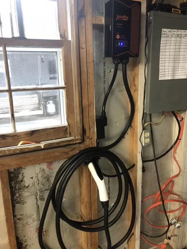

it's holding up well so far. I took some pictures after I came back from work. you can see my setup
14-50 NEMA outlet
6 AWG wire
50 amp breaker in main panel
