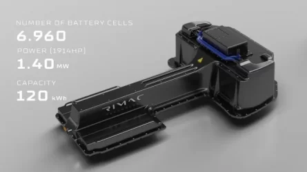

Until batteries get much more efficient, the SE is probably the last BEV that isn't designed around a height-raising slab-style battery. I hope I'm still around when a future BEV designer configuring a sporty BEV with a super-dense high-tech battery claims a breakthrough by putting the battery under the console between the front seats and under the rear seat.
The future is now! This is essentially how Rimac designed the battery for their latest car. This shape is optimized to keep the weight low and central without compromising the driving position.
Rimac has a very technical YouTube channel with their CEO/founder going over the entire design and development of the car in multiple in depth videos. I highly recommend it for anyone interested in the technical challenges of EV development.

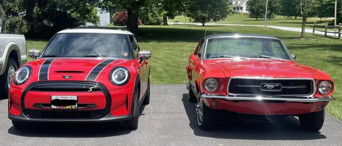

I was amazed to see how the current MINI compares to the size of the original Mustang. The Mustang is longer, but it's only 0.2 inches wider and much lower. My SE is the largest car I've ever purchased for my personal use (our Honda Clarity is much larger).

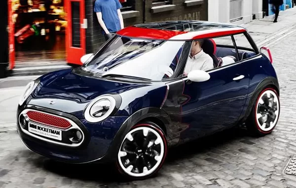

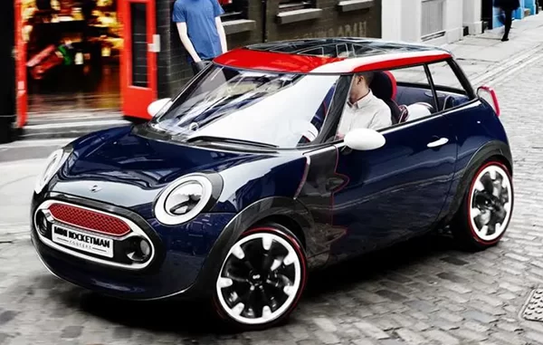

MINI keeps saying they'd like to reduce the size of their smallest car, but that would work against electrification. In 2019, Inside EVs repeated Autocar's claim that the tiny Rocketman (see below) would begin coming off MINI's production line in 2022, but there's no indication that's going to happen.
Hey that is my Mini and my neighbors Mustang !!! Love that pic and both those cars.
