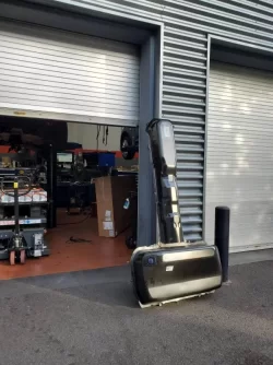

Stumbled across this on Reddit (supposedly a recall for a small number of battery modules).
The battery is a lot thinner than I thought it was! The case is obvious but you can also see the modules on the left below the car
