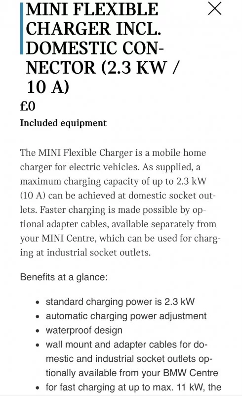

Ok that’s great to help visualize it. Now I’m waiting to see if it’s included on Canada-bound 23s; the UK configurator appears to include it as well, though without the “industrial socket adapter” that allows charging at “up to 11 kW.”
11 kW is only with 3-phase AC power and the North American SEs don't have a connector compatible with 3-phase AC power. When I read 11 kW charging on the SE spec sheet in 2019, I quickly replaced my 32-Amp EVSE with a 40-Amp EVSE. Then I learned about British 3-phase charging. Now I have a commercial ClipperCreek 40-Amp EVSE with a really thick charging cable.
Yes but AFAICT it’s the same FlexCharger.
The actual EVSE brick may be the same, but the plug for the car is going to be different. North America uses J1772, but Europe (3-phase) uses Mennekes, which has two additional power lines. And since the car end of the FlexCharger is non-removable, they're essentially different.
Right I think we’re saying the same thing, though. What I meant (that perhaps didn’t come across clearly) is that both the UK and US 2023 cars are being delivered with the FlexCharger (configured for their respective markets), so it’s possible that Canadian 23s will also come with it.
