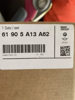

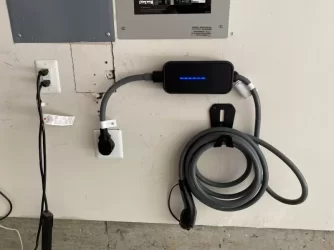

Finally got my 14-50 installed today so figured I would add some pictures of the EVSE installed. I ordered the wall mounting kit from some place in Germany as they aren’t easy to find. The picture of the box label is the part number for the wall mount. It works, but the way things are oriented, the ESVE wants to be below the outlet. You can see in the pictures that I flipped the outlet upside down (ground down) and mounted things sideways.
