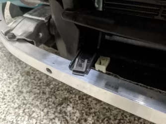

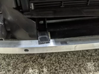

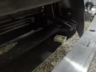

Here are the bottom mounts for the shutters. Both of mine were off and there isn't much to it. It doesn't stay securely in the hole at all.
The hole on the aluminum piece is where the bottom of the bracket goes. The grommet isn't big enough to keep the bracket in place.

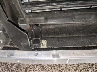

This is the bracket in place. Notice how it doesn't site flush and it doesn't stay in place.
I fixed mine by drilling a hole in the bracket and then secured it with a screw.
