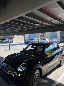

Thanks for the welcome o this forum. I wish to have this SE model I got it from the BMW website. This SE is the 2023 prototype. Mine is Iconic Black
