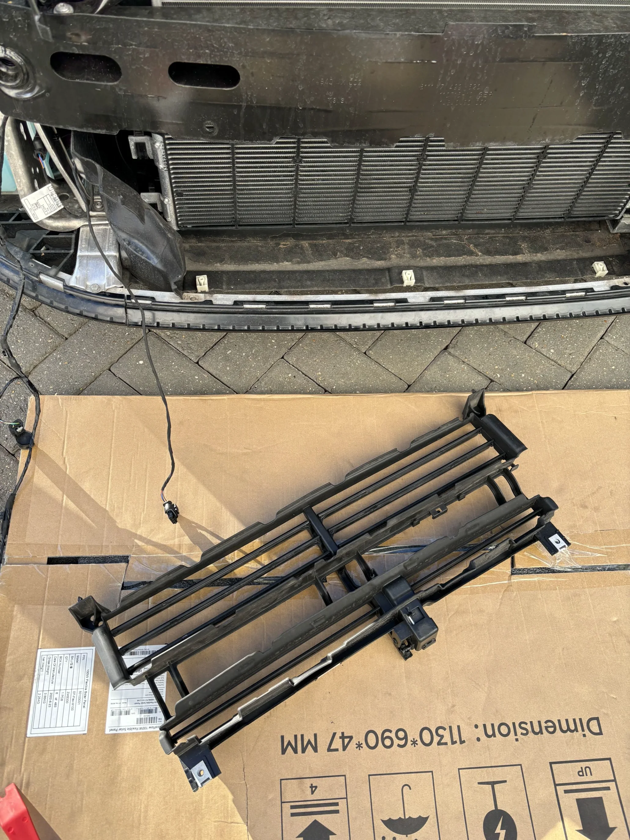

I had to remove this from my 2023 Mini Cooper SE L3 (Mini Yours) as it was catching on the new JCW bumper. 2 easy removable screws on the black frame.

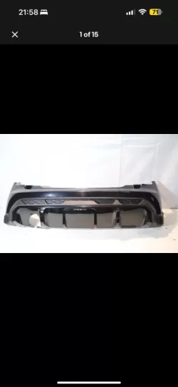

Your car looks even better in silver! You could do a road legal version of the Mini Pacesetter ;) If you ever think about doing the rear JCW on your car, I've got 2 JCW LCI2 rear bumpers for sale, a red one and a midnight black. Very cheap to respray to silver.

By the way-I wish I knew you had the bumpers for sale! How much out of interest?
