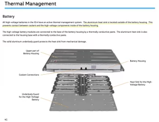

There were Korean automotive media articles published some years ago about some EVs unexpectedly bursting into flames some time after enduring manufacturer's crash tests, traced to coolant leakage shorting the cells. Coincidentally or not, while investigating the cause of Kona battery fires Hyundai/Kia changed to the LC coolant mid-production of the 2020 Kona. While unsuccessfully trying to find those articles online I ran across this document describing the ID4's engineering.
Rather than use a LC coolant VW designed this problem out in the ID4, as Hyundai/Kia have in the new Niro, presumably the upcoming Kona and I recently heard the latest Ioniq 5. I'm not sure how many other EVs do this or if any others use LC coolant.
It's not clear if this is a major real-world risk but it's certainly been clear that the LC coolant is far more trouble than it's worth.
