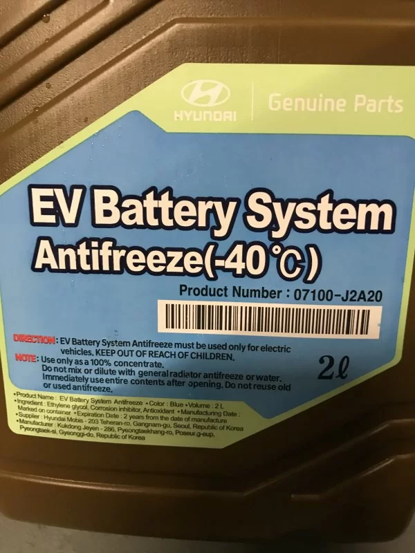

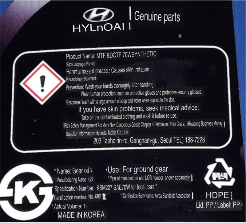

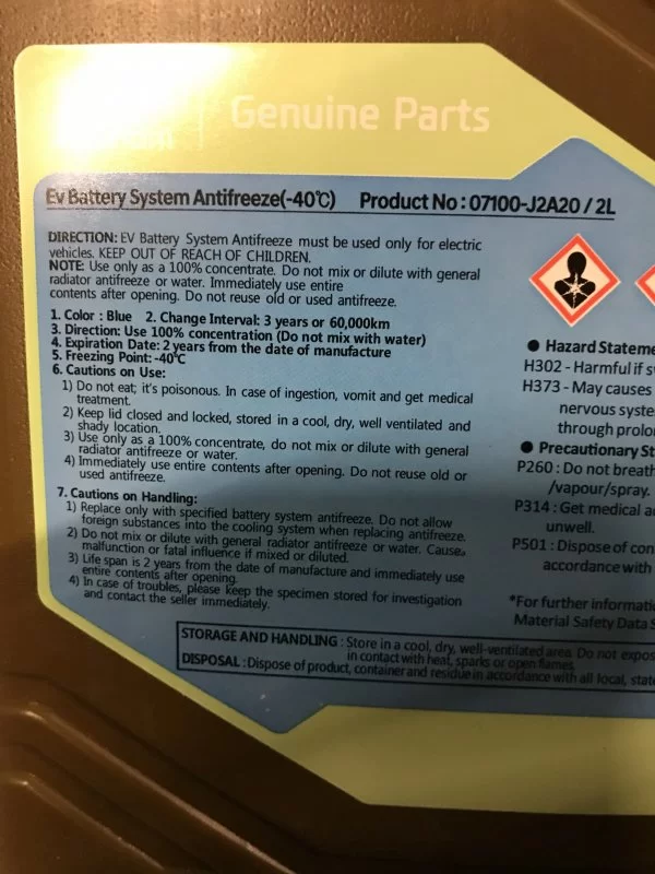

He re is all the stuff I manged to find.
On my invoice it is as Qty 3 EV BLUE Retail C$205.95 - C$0.00 to me
Not sure the cost is for each or total for 3.

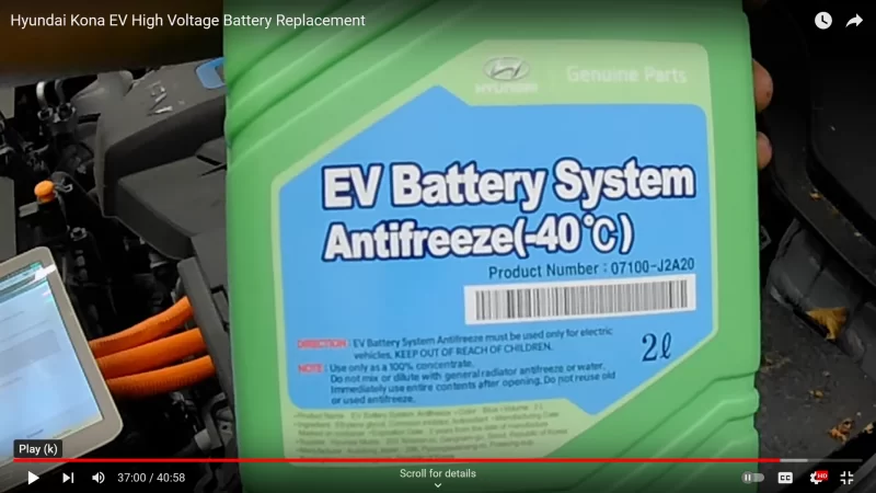

The picture of the coolant you provided is the same V1 coolant I had bought last year (at a discount for hedging the cost of the fluid change):
This is all V1 stuff that is no longer viable.
Both yours (gold/copper container) and mine (green) have the same product number 07100-J2A20. If yours is no longer available and I just got mine a couple of days back what gives? :rolleyes:
I give up!
