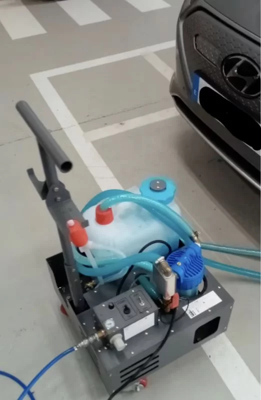

Dealers get this machine issued:
machine.webp Image stolen from TheSpider9319
Filters out these particles, noting the dark area at lower-left. Don't think jello is involved, at least as best as I'm aware.
View attachment 20853 Image stolen from TheSpider9319

Good pictures. Thanks for that.
So just like the TSB describes- use the pump to flush out and filter the crystal debris using the old coolant from the system(s) for 5 minutes, air drain for 2 minutes to discharge. After all systems are flushed, filtered and drained... reassemble hoses etc and add the new BSC-2 product via the reservoir tank using GDS-M system (Hyundai software) to perform air bleeding for 30 minutes by circulating the new coolant through the EWP (electric water pump).
Piece of Cake;)
I now have an appointment at a local dealer, a month out as they can't do it any sooner. They want to
have the car for a full day. It is a recall, and fully covered on costs. The person on the phone
was pretty sure they'd already done at least one other car by now; I told her straight-up I didn't want
to be their techs' first guinea pig.
I hate having to rely on them, but this is a rather complex job with all the special tools.
