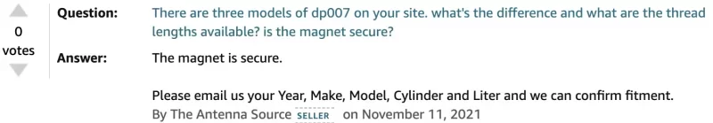

Certainly the last reference in the world I would ever rely on is the advice by vehicle model off any vendor website and Amazon is no exception. But Votex don't make it easy either because they want to match the application themselves and have consistently refused to answer my question (twice so far) about the difference between the three DP007 'variations'. And if I tell them the application they don't respond, presumably because there is neither an ICE (engine) nor automatic transmission present in the Kona EV. If I had my druthers I'd go for slightly longer thread than what we have now due to the cast aluminium housing and the risk of stripping, despite that the length we are using is identical to the stock Hyundai plug.
I know Votex have the same M18 plug listed under "automatic transmission parts" at a much higher price than the ICE engine version we are using. I suspect they are playing a game with pricing v.s. the perceived value of the application and don't want to kill the golden goose. An automatic may be accepted by consumers as a higher-value application than an engine. When you inquire about ordering a DP007-1, -2 or -3 directly from them they know what price you have seen advertised on reseller websites based on that requested dash number. But it's the same part. The packet has no dash number on it.

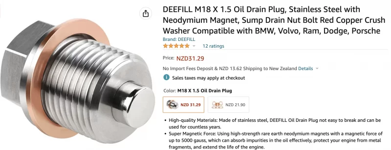

I'll be looking for another source because this question (what magnetic drain plug to buy for the Kona EV) is asked of me weekly in various forums and I hate to keep giving business to a company who is not fully transparent. I've got my eye on this Chinese-made part that appears to be longer and have posted a question about the length. Fortunately M18-1.5 is a very common thread for drain plugs.

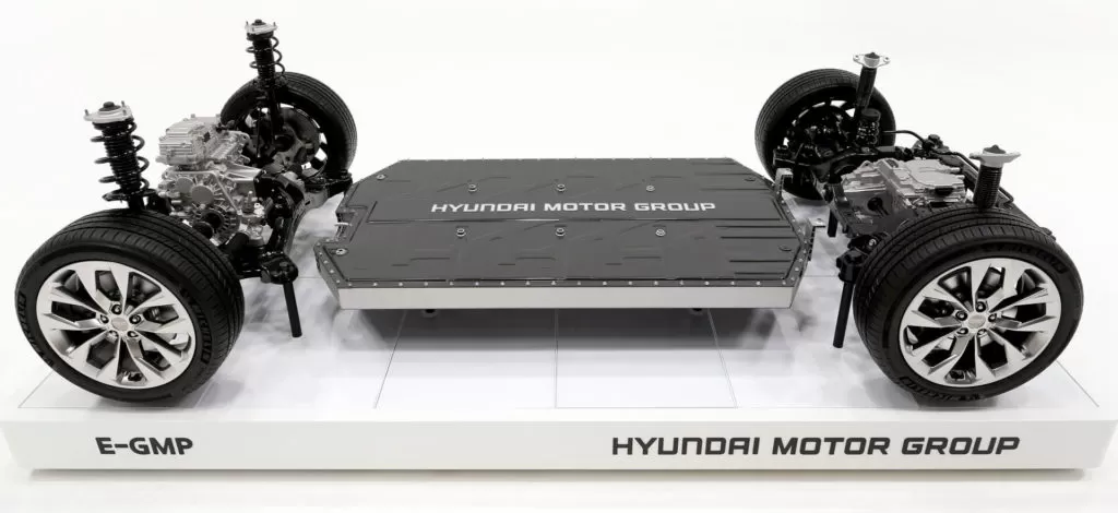

Does the Ioniq 5 (and EV6) have the same type of gearbox and motor configuration? And how does it work with AWD, is there a gearbox for each motor?
I know Votex have the same M18 plug listed under "automatic transmission parts" at a much higher price than the ICE engine version we are using. I suspect they are playing a game with pricing v.s. the perceived value of the application and don't want to kill the golden goose. An automatic may be accepted by consumers as a higher-value application than an engine. When you inquire about ordering a DP007-1, -2 or -3 directly from them they know what price you have seen advertised on reseller websites based on that requested dash number. But it's the same part. The packet has no dash number on.
If the drawing is accurate, the pitch of 1.5 =16.93 threads per inch

I count 8 threads totaling .4725 inches or 12 mm long.
Looks like very good manufacturing materials although I wouldn't count on reusing that copper crush washer.
Different gearboxes and motors altogether and a separate gearbox for each motor.
The motor, inverter, and transmission are integrated into a single unit.[ Hyundai claim the motor is approximately 10% more efficient than a conventional motor due to "hairpin winding technology", allowing the coils to be wound more densely, and more effective cooling.

Adding to EE's post, the E-GMP motors are oil-cooled like that in a Model 3 and Chevy Bolt. As such there is a lot more oil, 3.5 litres, and it will have a pump. Also, the oil has changed to an ATF, Hyundai's own spec SP4-M, same viscosity and a full synthetic but I suspect less easy to find than what we use.
The question has arisen as to if the Ioniq 5/EV6 will have the same issue that we have and I've suggested to one owner that they draw a sample out via the fill opening. Because any pumped oil system must have some filtration (because pumps hate metal particles), I think the problem will not appear.
