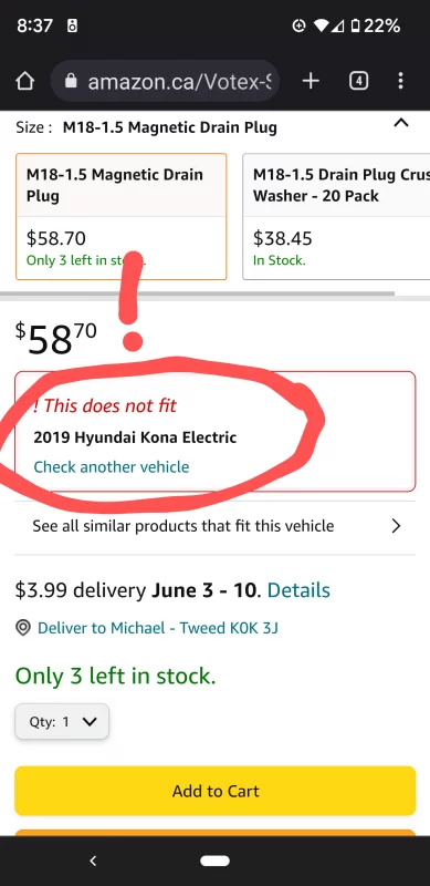

Thanks but...
And the price?! For a little plug? Yeesh.
Thanks but...
When I go to Kiwi's plug link I do not get the warning. Not only that, I have installed two of them in my 2021 Kona EV, one in the fill port and one in the drain. I am sure there is no difference in the plug threads between 2019 and 2021 models because the plugs worked for Kiwi on his earlier model. They spun up on mine with fingers so the threads are right and were tightened with a torque wrench to specs. IE, they DO fit. I don't know what your Amazon page's warning is on about. Probably some frigging' lawyer has got involved and made Amazon do a disclaimer. A pox on all their houses, creating fake misery so they can feed off it like the carrion eaters they are.
