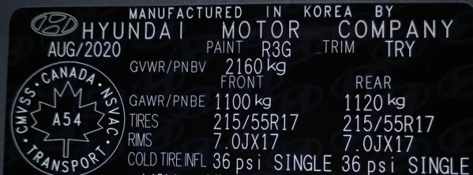

  14. Well darn it. I ordered a Draw-Tite #24976 hitch assembly, it arrived last week, and today I finally had some time to work on the install.
    I was able to remove all the plastic trim bits underneath, and hoist the bar into its approximate location, but sadly, the inside width of the 2 mounting brackets is (approx) 3/8" too NARROW (I couldn't accurately measure with 1 hand holding the bar at an angle). The inside width dimension of the Draw-Tite I have is 43-1/4", and the outside dimensions of the Kona frame in that area is wider. I couldn't measure since the rear storage pan dips below the frame rails. There also seems to be some interference with a weld to the rear of the car.
    My vehicle was built IMG_20201019_2048492.jpg in August 2020, and is a 2021 model year.
    So, I don't know if returning my existing, and trying to order a Curt #11529 will result is one that actually fits.
    The nearest UHaul place that installs hitches is in Moncton about 2 hours away, so I don't know how effective it will be to try and get them to supply and install one.
    Can anyone confirm that their 2021 model year accepted a Draw-Tite 24976 or Curt 11529?

  16. I was preparing to return my Draw-Tite 24976 Hitch because it was too narrow (see previous posting), when I noticed that the mounting brackets were not flat nor parallel. When I originally unpacked the box, I noticed that the foam blocks used to keep the hitch steady were loose and flopping around, so I believe that the hitch was damaged in transit as the 34 lbs was tossed around by the delivery guy.
    So, I took the hitch to a local welding shop, where they were able to straighten the bent flanges so they were in a flat plane, based upon where the cross bar was welded on. I returned home, and test fit the hitch assembly. Lo-and behold, the hitch fit like it should have!
    So to retract my earlier statement, the August 2020 build, 2021 Model Kona EV DOES ACCEPT a Draw-Tite #24976 Hitch…. This assumes that the flanges are not bent!!!!
