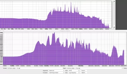

  19. I did have a look at the spectrum and there is significant noise above frequencies that the VESS produces. You really should make a recording with the VESS unplugged to make any sense of this. My VESS is the upper graph recorded when the car was stationary, see image. Your VESS may be different because the car is 'moving'.
    eastpole, Domenick and Brennan Raposo like this.
