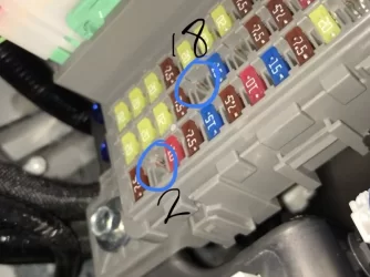

First thing’s first, if you’ve made no other electrical changes to the car, you can use the 3-wire hardwire kit for the A129 without piggybacking on any active fuses. You’ll want to use slots 2 (ACC wire) and 18 (BATTERY wire) in the driver’s side footwell (under the steering column to the left) which are both empty.

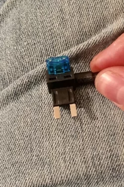

In addition to the 3-wire hardwire kit, you’ll also need 2 fuse taps (this is the pack I ordered: https://www.amazon.ca/dp/B01J9GTL6O) to connect to the hardwire kit leads (VIOFO also sells fuse taps so if you’d prefer to get theirs, you can). Once you’ve connected the taps to the leads (use a crimping tool or a pair of needle nose pliers to pinch the taps onto the leads), insert one of the included fuses into the top slot in the tap. With the tap’s pins pointing down and the fuse slots facing you, insert the fuse in the top slot (see below).

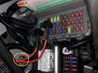

Now it’s time to connect everything. The tricky part for me was getting to the ground post. Sorry I didn’t get a good picture of it but if you’re looking at your fuse box, you can’t miss it. It’s in behind and just below with about 342 ground wires already attached to it. It’s circled in yellow in the next picture which also shows the fuse taps connected to the fuse box.
You’ll need to loosen the bolt a little so you can slide the ground wire pins around the post. Tighten it up and you’re in business. I found that I had to pry the plastic plate with the fuse diagram on it off to give me enough room to work. This cover takes some dedication to get off but it does come off and goes back on surprisingly easily. The nice thing about doing this is that it makes tucking the hardwire kit’s fuse wires behind it much easier.

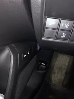

Once you have the fuse taps plugged into their respective slots and your ground wire secure, tuck the coloured wires into the space below the fuse box (where they’ll be covered by the plastic cover). Pull the in-line low voltage protection box out toward the driver’s side door jam before replacing the plastic cover. Run it out the left side of the plastic cover not over the top of it.
You should now have everything in the footwell tidied up and a small plastic switch box and long USB cable dangling out your driver’s side door. See below for placement of the low voltage protection box. It fits PERFECTLY in this space, leaves the switch easily accessible if you want to change the setting (say, if you know you’re going to be parking your car for an extended period of time and want to protect your 12V battery), and this orientation has the high setting at the top and low setting at the bottom.

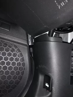

I wonder if you could take some pictures of how you routed it around the A Pilar to avoid interfering with airbag deployment....
I got some feedback on this on my post on Reddit. It’s pretty tight and running the wires (for the hardwire line and the rear camera) behind the airbag is a bit tedious but it’s doable. I was rewiring my incorrectly wired install so I ran the cable from the door frame under the airbag toward the camera (not from the camera, under the airbag, toward the doorframe as I indicate in the instructions) and I managed to get it. The included cables have some chunky parts (ferrite core and the USB connectors themselves) that require some nudging to get through. I feel like coming from the other side (across the headliner to the pillar and under the airbag) would be an order of magnitude more difficult because visibility would be practically 0.
This is the best picture I could get of the wiring under the airbag at the seam between the headliner and the pillar of the driver’s side door:
