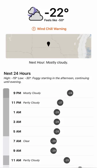

I happened into my weather app tonight as we were at the magic Clarity temperature; couldn't resist sharing. And no, I'm not going to see if the car will start. I don't need to know bad enough to subject it to the stress of cranking up at this temperature, not to mention subjecting my body to being there to push the button.

Awwww, come on MNSteve. How about tomorrow morning in the "interests of science" (aka plain vulgar curiosity) --for the team. Seems like they are not predicting anything lower than minus single digits here.
Don't go out there until it's -23 F. Otherwise, we won't really know if Honda put in a magical shutoff at -22 F or they approximated. :)
Agreed. Problem is that the car is parked in an unheated garage. We will see tomorrow.
The other week, we hit -21C and the ICE came on immediately even with the battery fully charged. Everything ran well.
