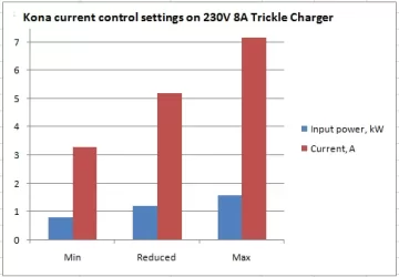

Aside from the consideration that AC charging at any level accommodated by the Kona's OBC is considered preferable over DCFC (noted in the owner's manual), a likely advantage of keeping it on Max is that the overall efficiency is better. I only charge at 7 amps 230V and fixed OBC overhead losses are sustained for many hours than if I could use a higher rate. I think I get only around 80% into the battery.
At 32 amps I could get as much as 90%.
In any case here is the effect of those settings with my "8 amp" EVSE.

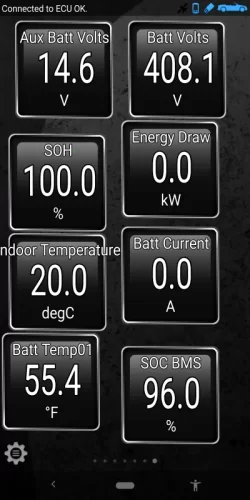

I own My 2nd Kona EV Ultimate 2020 I did two HV Battery software upgrade and I notice 90% on dash indicate with torque pro is =86% this is reality. On occasion I do charge with my 32A -240V charger to 100% =95.5% also is very slow with very low current .This real !!!!!!
Yes this is real, nothing unusual here. Your torque pro reading is likely the normally hidden BMS reading of the actual battery SOC.

You are using the wrong SOC pid.
Delete State of Charge BMS, and load the pid State of Charge Display, which shows the same data as the car console...
Thank You I done that. How can I change indoor temp shows in F?
The battery pid you are using is a US conversion, not the original, which shows temps in C, as follows:
