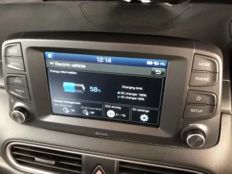

Sidebar question: is there any actual %SOC indication on the Kona (preferred), or is %SOC simply implied by the energy gauge level and the range in km as indicated on the standard instrument panel? Thanks.
%SoC is displayed when EV operations are accessed on the console, but is not otherwise available as a default display on the dash or the HUD.
Thanks! I'll check it out next time I'm fiddling with the settings.

In my TM3, my personal technique is to simply have %SOC showing at all times, so it becomes a simple "fuel gauge".
I'm not sure if your Kona model has a user-programmable "star" button on the centre unit but I set mine to bring up the battery SoC screen.
Haha, I had that too until I realized that there is no "home" button. Which makes it a pain to switch to Android auto from the SOC screen or the map screen (when I use AA for music). So I reverted back to having the star work as the home button.
From there is only one tap to the EV menu which shows you the SOC.
There is always the Home “button” top left of the screen.
However, at least in my ‘19 Kona, you have to choose between the sat/nav screen or the %SoC screen, so back to TP...
On my RHD version the star button is an easier reach than the EV icon, and by feel alone, so I like it set that way. Mine came with a Home button but it seems they repurposed that for NAV versions, which my base model doesn't have.
