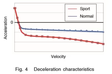

Although I have no information to disprove it, I have the impression that SPORT mode doesn't just remap the pedal input but also may change the performance of the drive components (PCU, VCA, IPU, inverters ... whatever). I could be flat wrong - just a guess.
Perhaps one reason I feel that way is the different regen behavior shown in the same paper which shows that Clarity FCV SPORT mode enables more aggressive regen:
Again - assuming that this FCV regen curve, along with the others, are meaningful to our PHEV under discussion.
